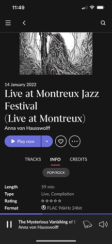

I’m not having between track delays but albums that should be/were gapless no longer are.
For example this one.
I’m using a microRendu all is connected by Ethernet.
EDIT: Just switched the Rendu to DLNA.
Using mConnect with Qobuz the album is gapless.
