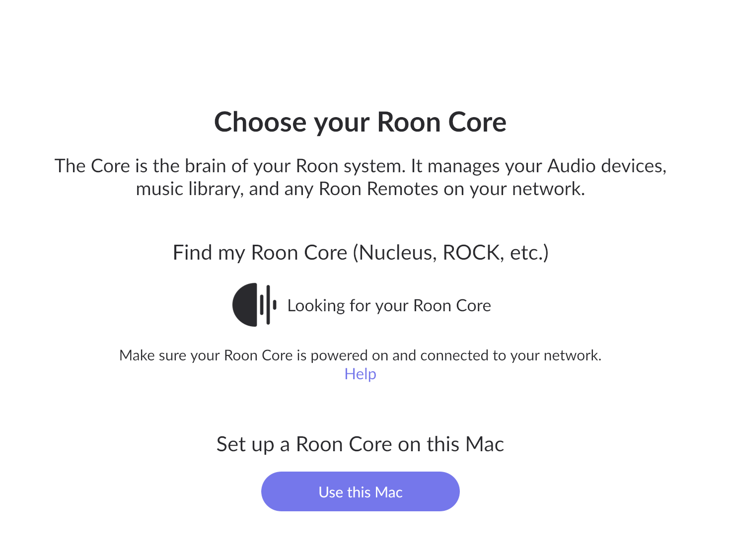

All of a sudden my Roon Core is missing. My core is running on a Nucleus (and has been for some time.) I’m not able to locate it through either the desktop app or through the Roon Remote on my iPad.
Sounds like a hardware failure. But I would start by shutting everything down including your router. Then restart everything beginning with the router and ending with the Nucleus. If it still doesn’t show on the network you have to start eliminating cables, etc.
I did the hard reset. Still no luck finding the Nucleus. I tried disconnecting power to the unit and also the switch. A couple of observations:
