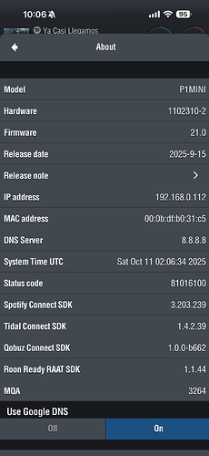

Hi Peter. Still getting issues - predominantly with Spotify when one stops playing the unit fails to go into standby (red led) on P1 mini.
The tab off is on and it appears the usb does drop the voltage as the amps turn off with the trigger cable.
Here is an about screen shot but soon as I access the p1 it wakes up and the amps come on so not sure if this is relevant now

Please list the exact steps how you “stop” Spotify, e.g. switch the device from P1 to phone? Pause without switching device? Press the standby button on physical remote? Using the standby function on the Lumin app? Let a Spotify playlist complete without Auto Play? There may be other ways too.

That’s most likely an app display issue. The next time you see it please bring up the iOS task list, swipe Lumin app away. Or on Android Force Stop Lumin app.
That makes sense, thanks.
Lossless yes all good now
Hard to pin it down as I’m not the Spotify user in the house but I think it’s when the music just stops like it’s transferred to another device the red light never comes on to show standby but the display is blank and the usb off is in effect
