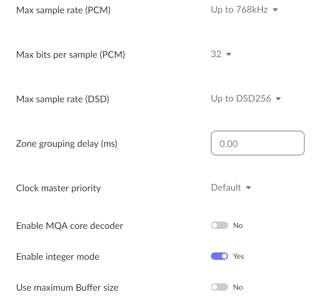

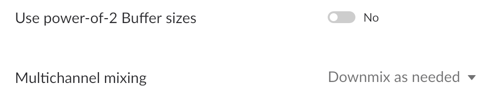

  4. You will find attached the settings I’m using for the DAC

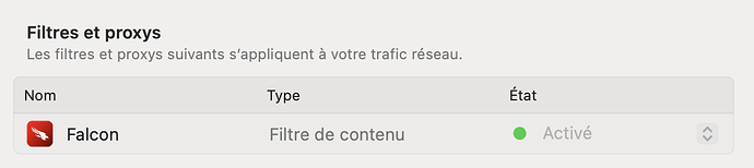

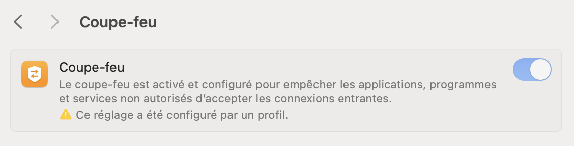

Here’s what I see in Network > VPN & filters and Network > Firewall settings (I can’t show more as the access is limited by my company)
There is also a VPN named “WARP by Cloudflare” installed that I can activate or not (I’ve already tested on both configurations and it doesn’t change the behavior)
And indeed, I’m also using ZeroTier (both installed on my NAS and my Macbook) in order to bridge my home network with my office network, but again I’ve tried disabling it and still get the playback drops. (After rebooting the Roon app of course)

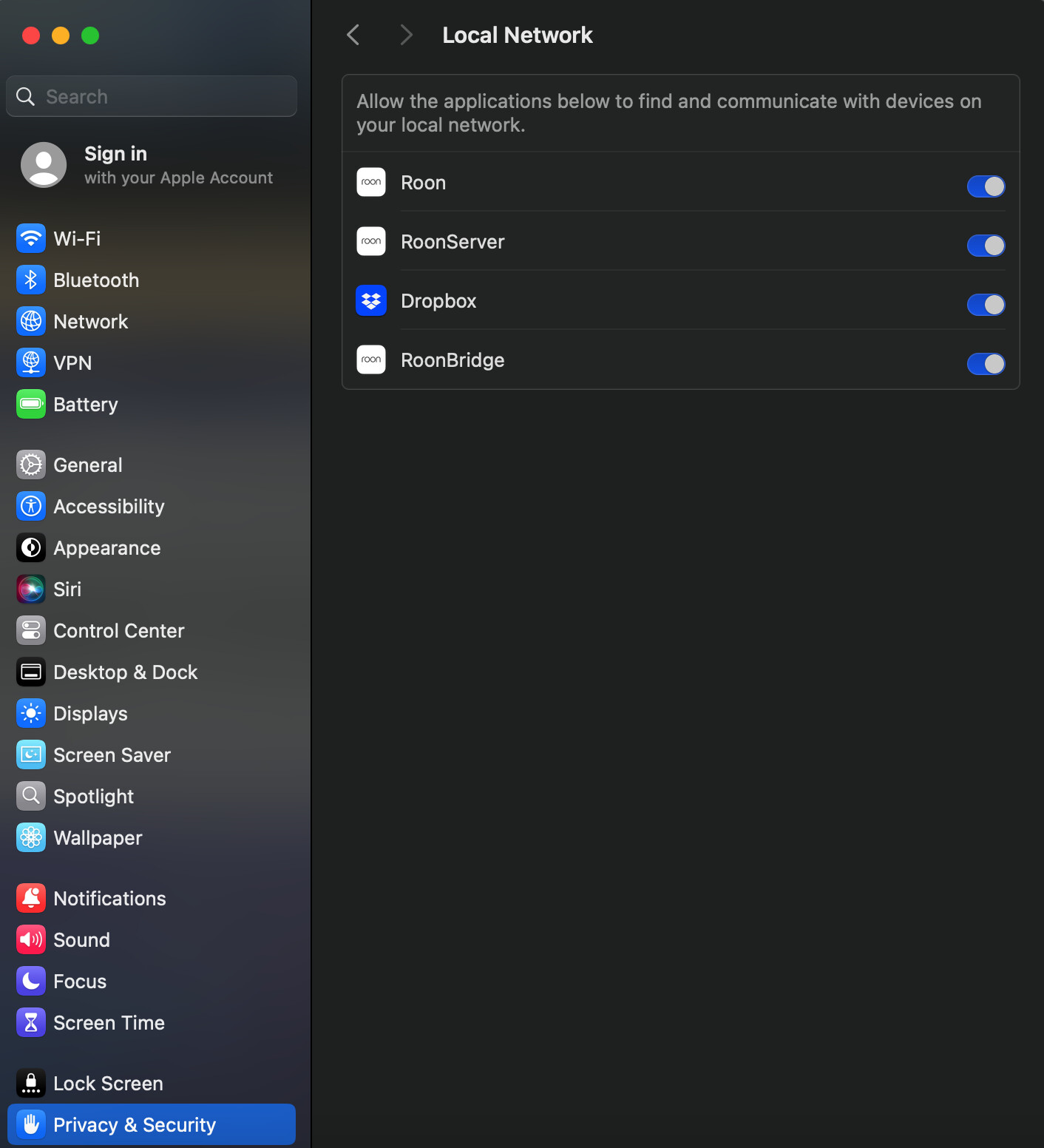

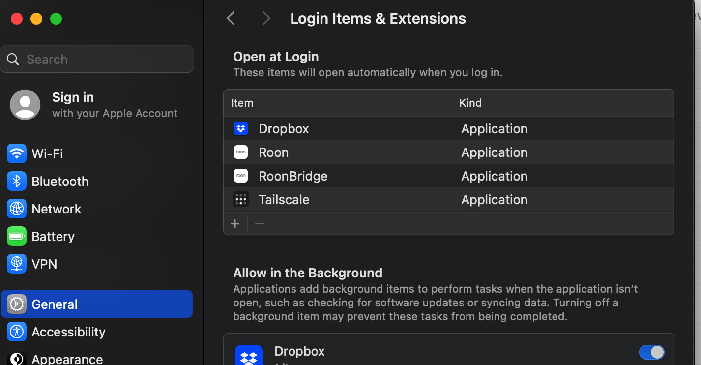

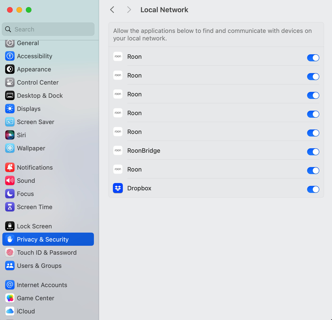

I would like to report that I’ve personally experienced zero difficulty throughout while working on my network although I’ve observed abnormalities on at least 3 separate installations of Sequoia. These 3 installations alternate between endpoint and server on each machine during my testing.
All three have Roon Bridge installations as well. Two of the installations show Roon and Roon Bridge in the “Login Items and Extensions” section of system settings. The third installation shows these two as well as “Roon Server” in this section.
Toggling off Roon or toggling it on seems to have no affect on performance one way or another when toggled under Privacy & Security in the Local Network Section
Roon is completely stable and functional in all cases. The attached image showing multiple Roon instances is common to a single computer. The image is taken from a 2020 MacBook Pro running Sequoia 15.0.1 fresh build.
Add images

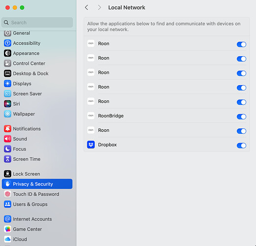

@Connor ,
I’ve attempted unsuccessfully several times through installations to replicate the install of the Roon Server extension in the “Login Items and Extensions” section as it appears in one of 3 installations. Can you help with this? In the past I knew of a conflict where I could not have a team viewer extension as well as a team viewer host extension on a Mac wondering if it’s a similar natured issue.
Should the Roon Server extension be visible? Also FYI I have made certain that Roon has local access during installation.
