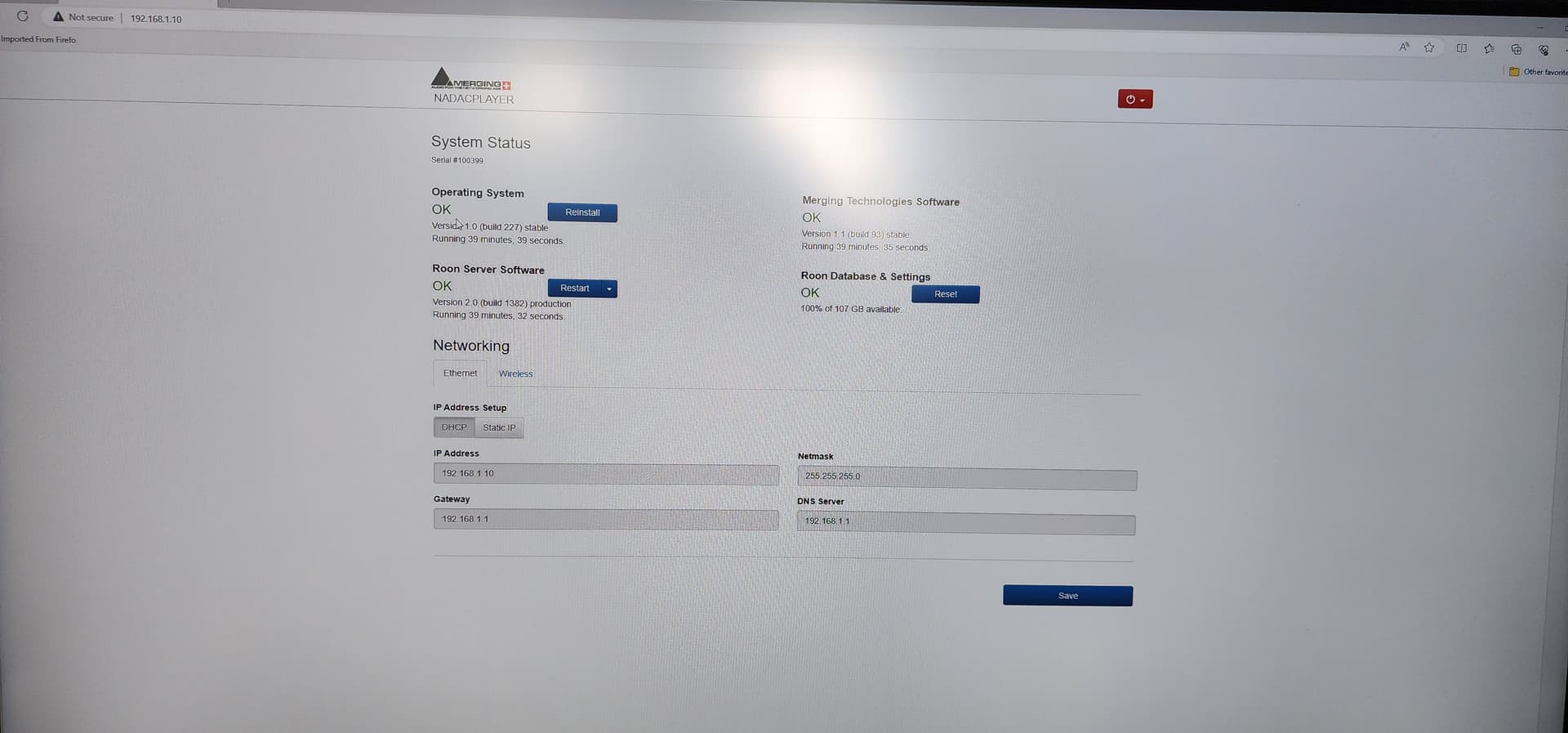

this seems to be mostly a merging issue in my case. I’m overriding it currently by running the core on my mac mini.

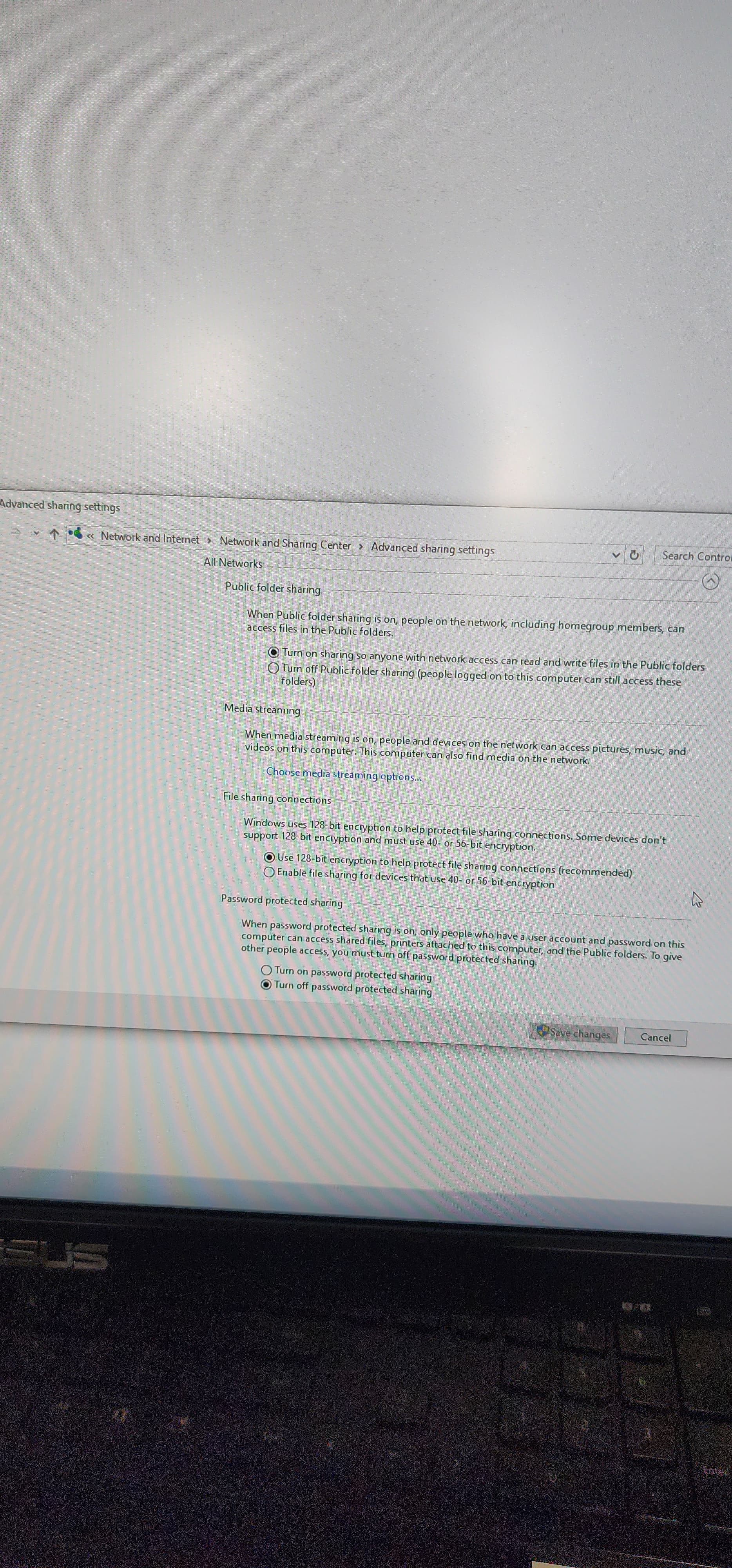

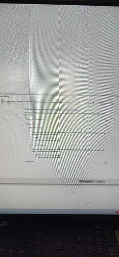

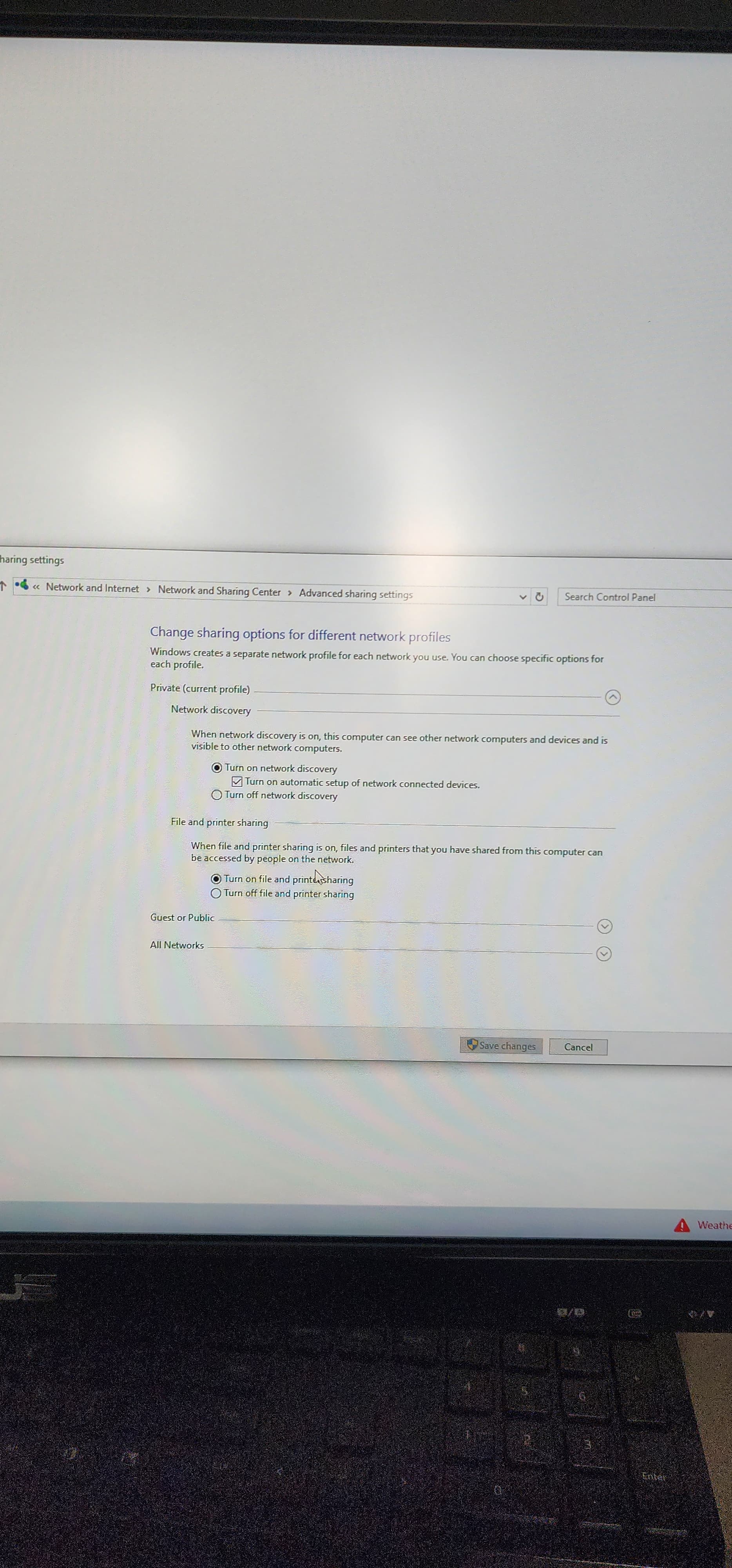

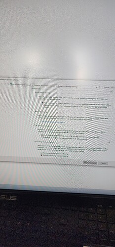

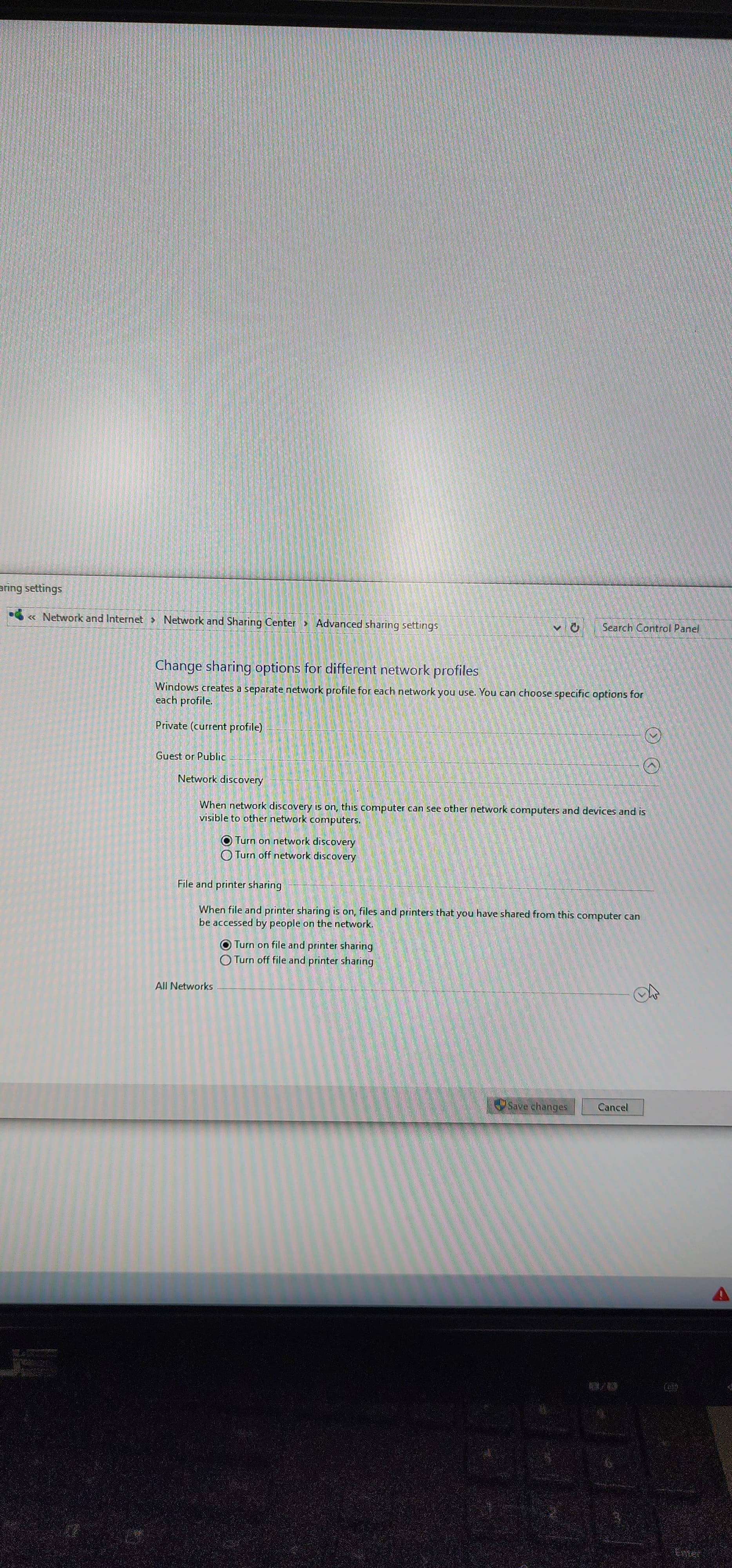

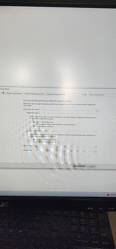

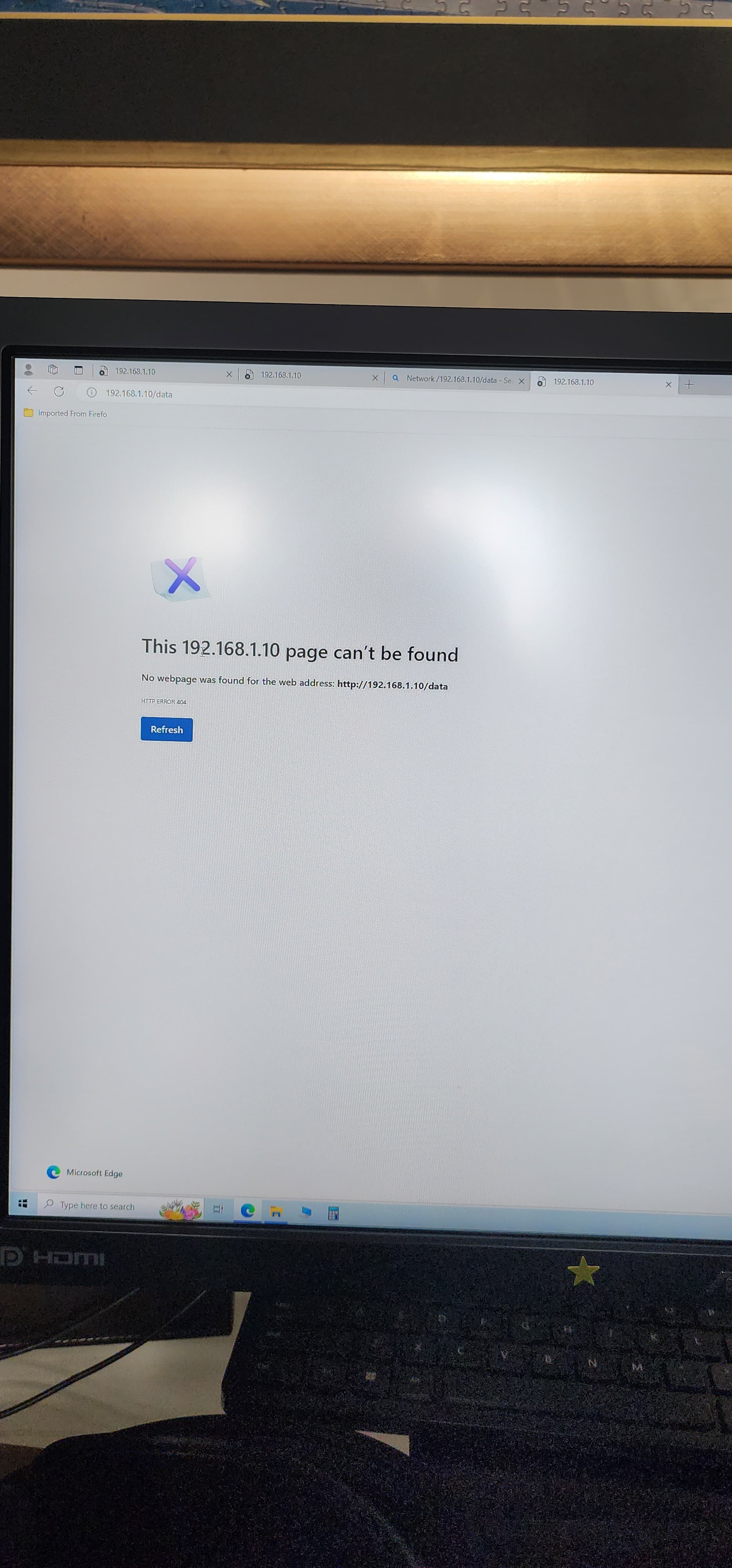

howdy i tried the above i can get to here…
but not to data…
i checked my network setting they seem open
cheers
steve
Maybe because you are not using a file browser but a web browser instead?
no i was using forward slash not back slash. all fixed thank you

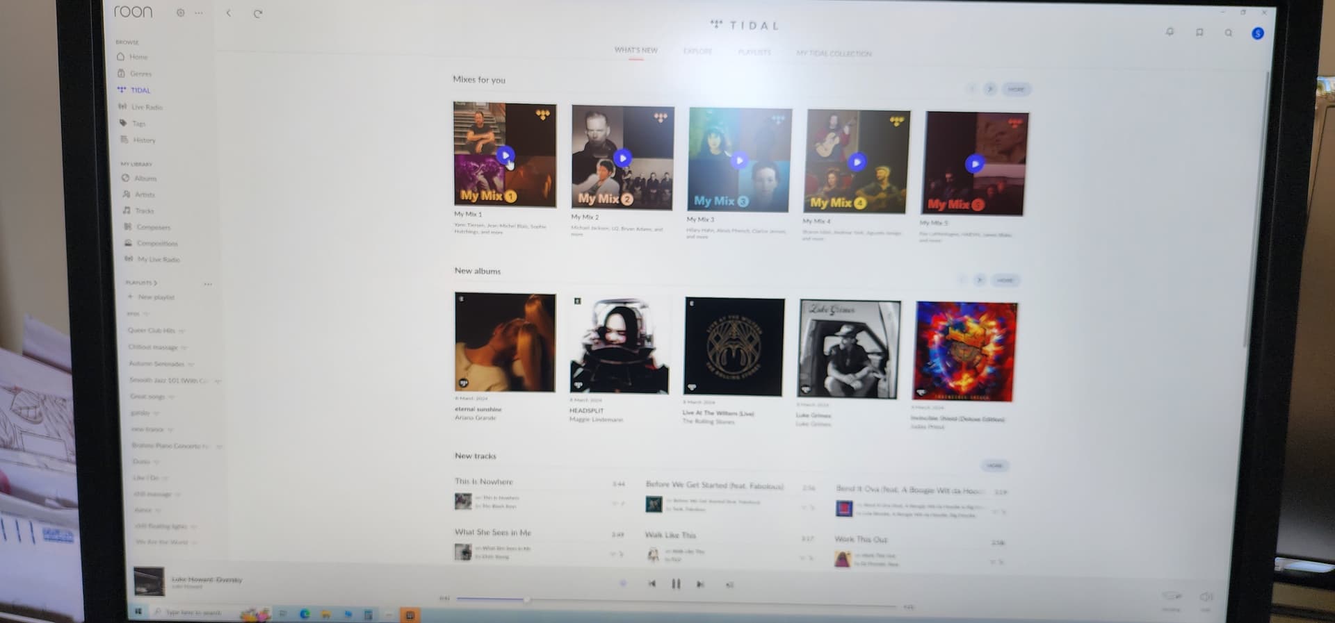

so i got roon working with my computer…

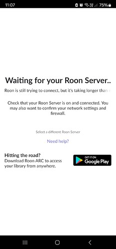

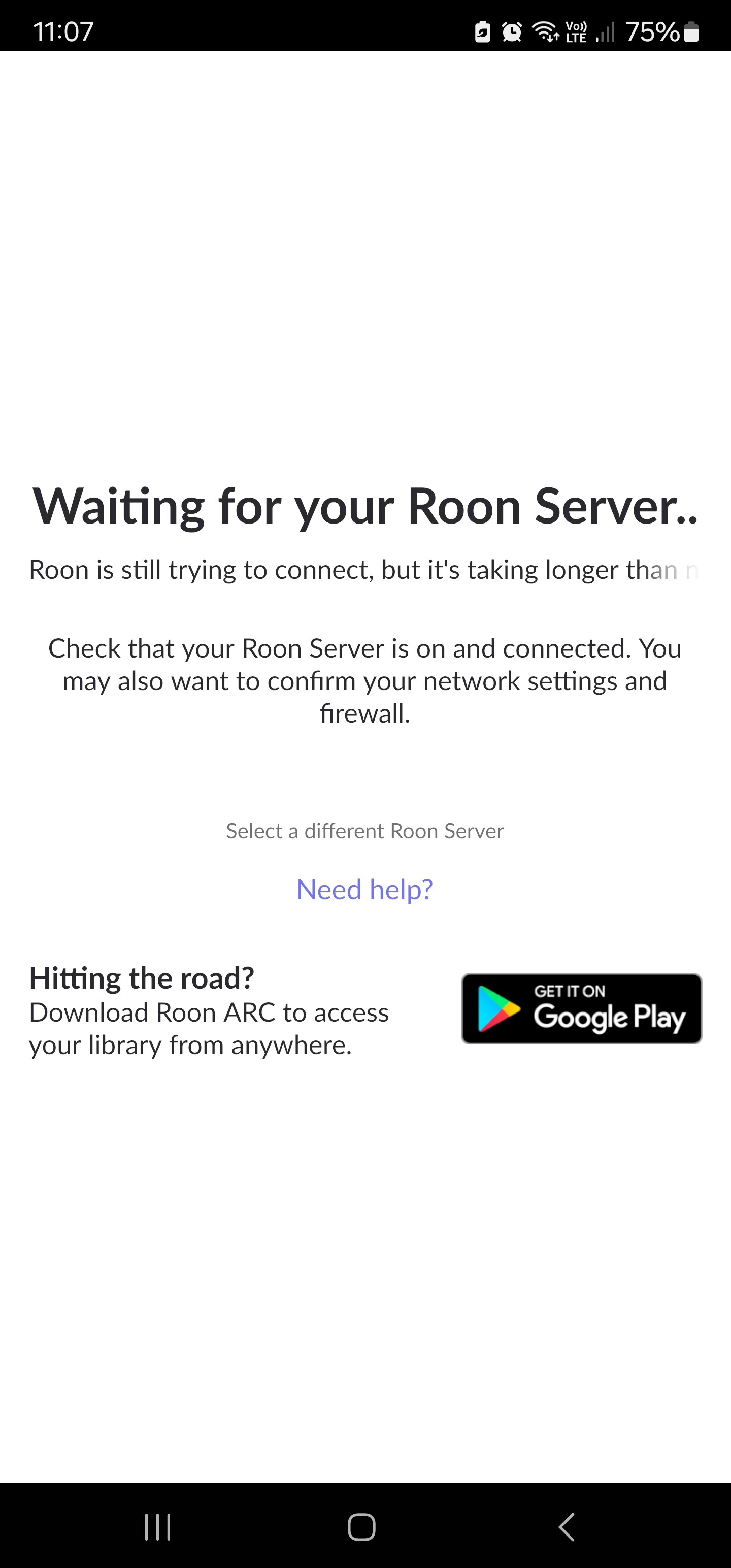

but not woth my phone s22 ultra
ive tried uninstalling the app and reinstalling
What happens if you tap “Select a different Roon Server”?
yep all solved cheers roon. ps. no response from merging yet
