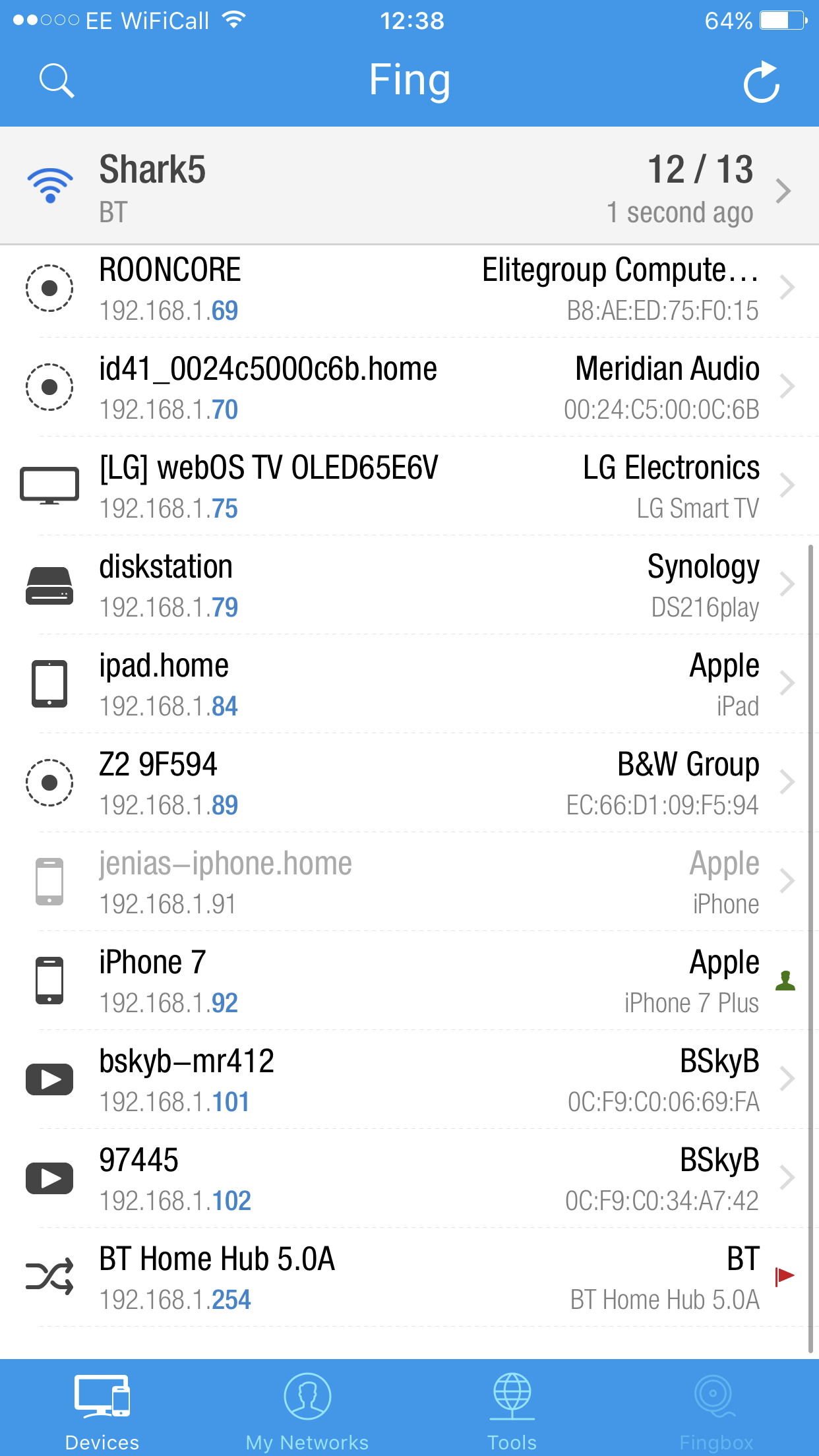

Can you see the ID41 via a network scanner?
Russ
Hi Russ.
Yes it is visible in the network scanner.

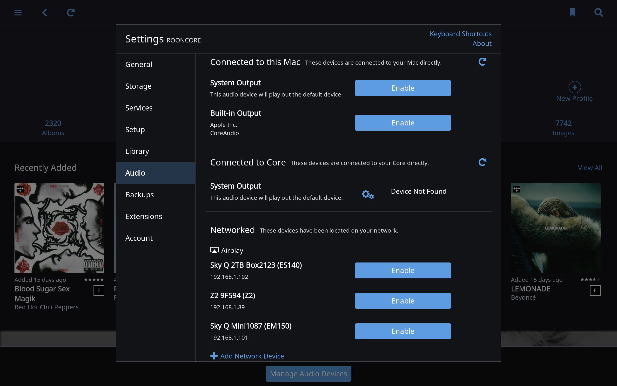

Can you post a screen shot of your audio settings screen ? Let’s be sure that the ID41 zone is enabled. Just rule that out.
Hi Nick. Absolutely.
It is worth noting that all previous updates ran super smoothly for me (have been using my new system for 11 months). Perhaps, as I suggested might be related to the fact that my 818v3 is operating without a Sooloos core, so has not been updated for those 11 months. And currently meridian web-site doesn’t have a working link for Sooloos Configuration app for I could update my ID41 firmware. But that was just a guess of course as the system was running smoothly before the update.

Yes that is exactly what I started with - turn all the equipment off completely including the socket power switches, checking the Ethernet cables connected properly, then restarting the network (switches and router), then starting the Roon core and the Meridian products.
As you can see the ID41 is on the network.
