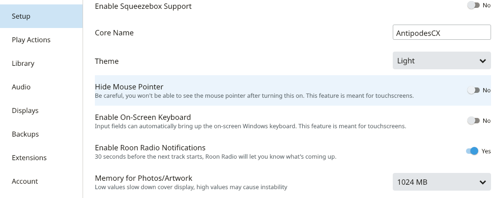

I was experiencing the same issues, also with the Antipodes CX with the latest version Roon and latest firmware. Restarting the core had always helped but the problem always returns and last time it even persisted through the restart. Then I found the solution in a related thread: Red Warning, software needs updating
In short: “Roon setting and setup increase Memory for Photos/Artwork, restart Roon. Red warning is gone.”

Update: even with the adjusted memory setting, the issue still pops up occasionally, usually after a restart of the CX and EX. Just checking Roon’s About section I noticed that Roon also had an issue checking the CX’s software version, see image below.
Shortly thereafter, Quobuz stopped playing and Roon displayed the below message:
Another restart of the CX fixed it again. Not sure now if this is actually a Roon issue or something to do with the CX or perhaps my network. The latter does seem perfectly stable otherwise.
Another update. After I got the above two issues again and even two successive reboots of the CX would not fix them, I restarted the Roon Server application in the Antipodes dashboard. That did the trick.
