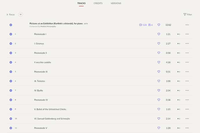

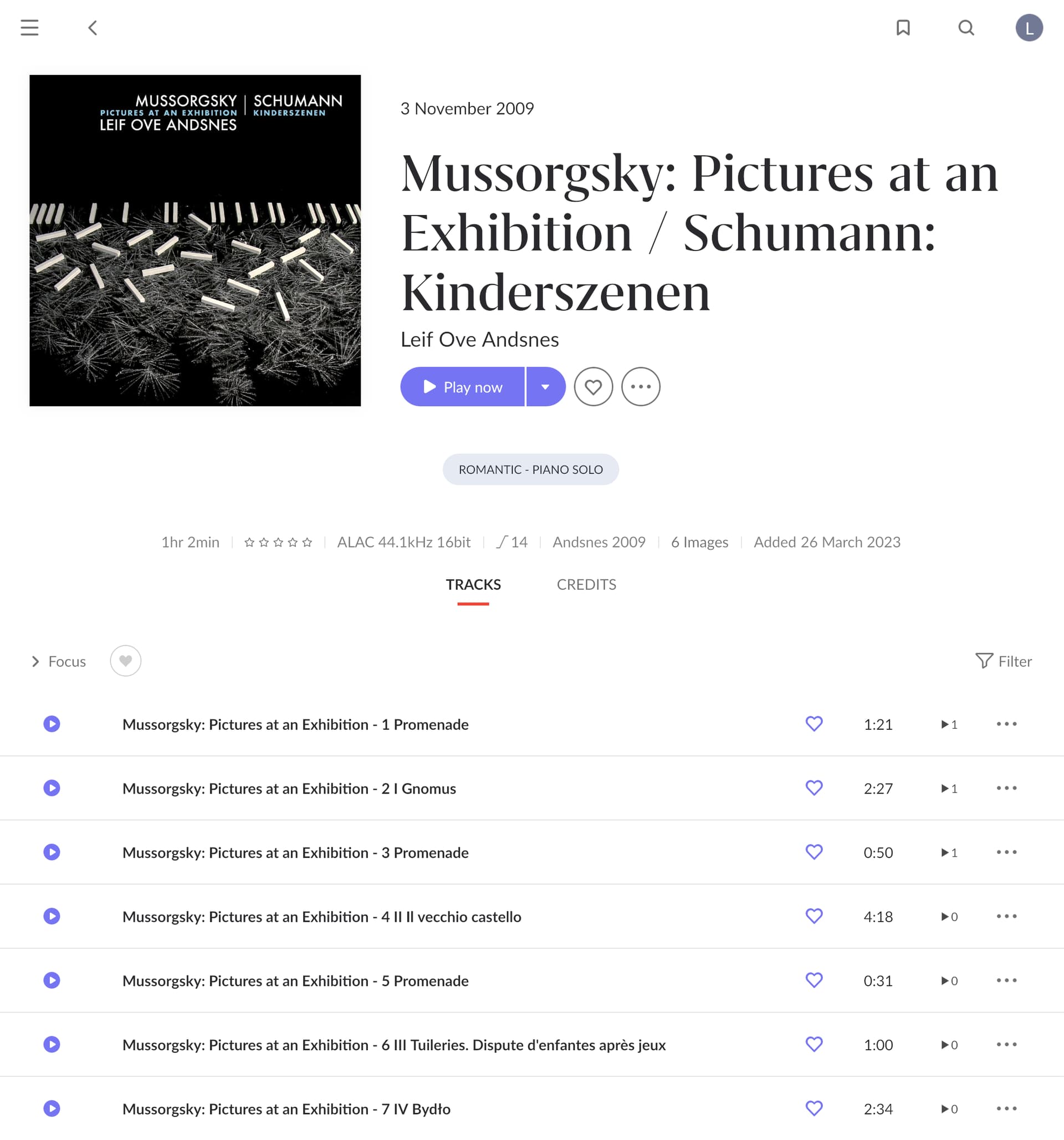

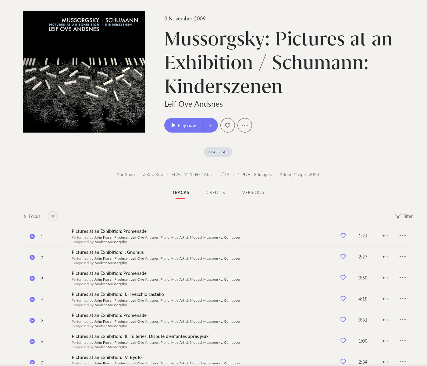

I love Roon’s ability to randomly play a classical Playlist without losing sight of compositions. However, this fails miserably when movements aren’t identified as being part of a single composition. This is precisely what happens with some of my albums. Here is a recent example:

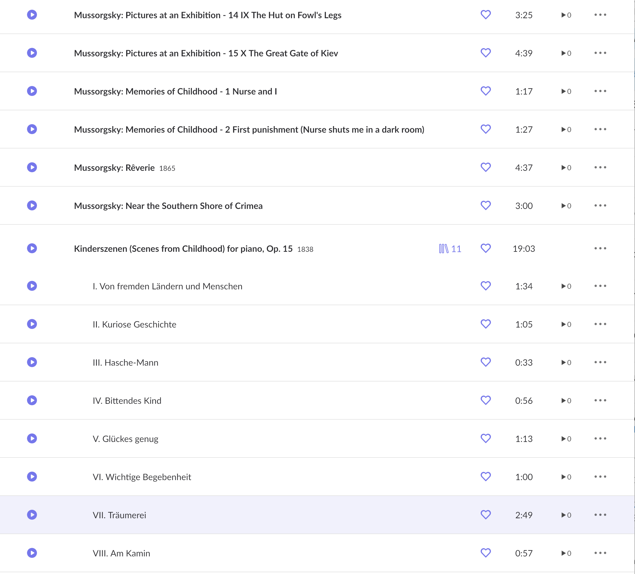

Pictures at an Exhibition is a single composition, not 15 different ones! The same album contains Schumann’s Kinderszenen

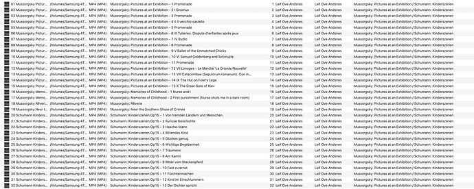

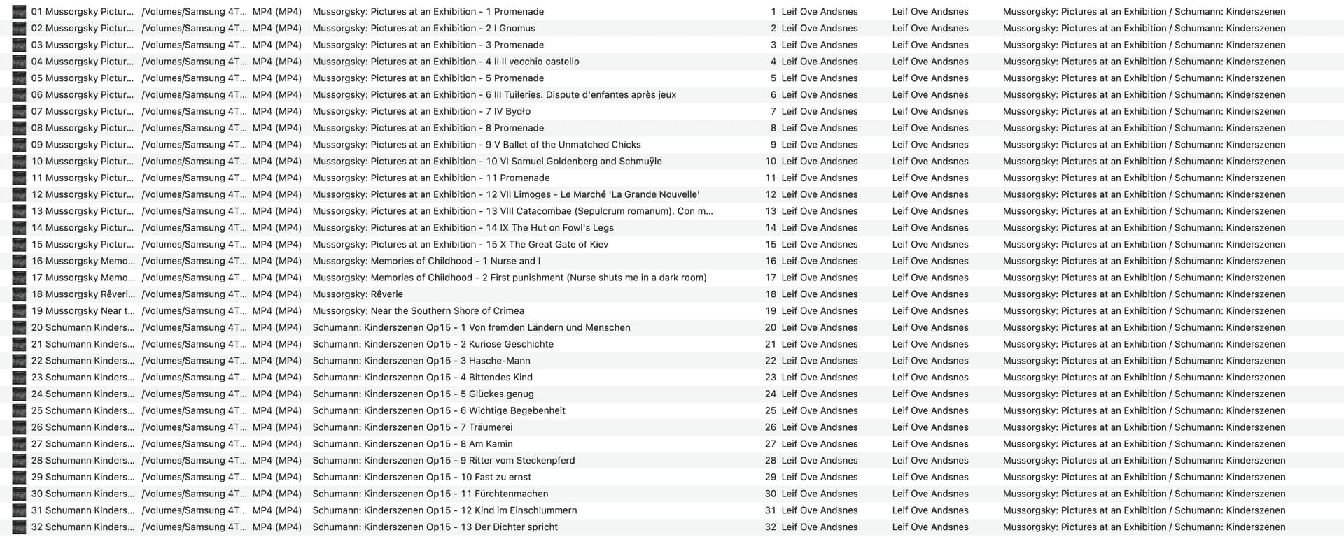

and this is recognised as a single composition. The tagging is identical:

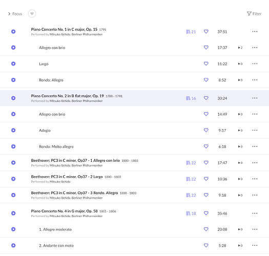

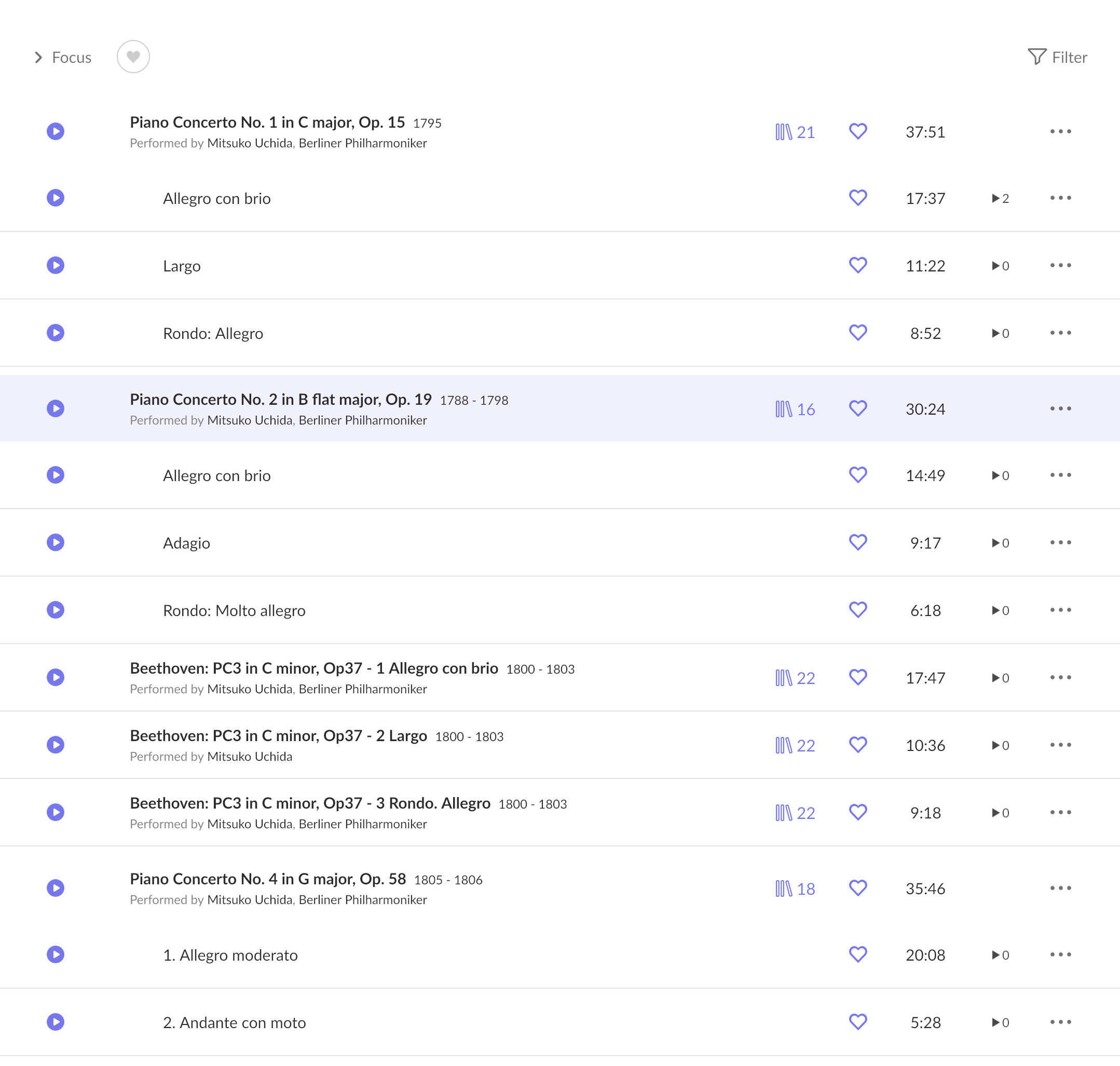

Before someone suggests it may have something to do with the complex history of this piece, the same happens with Beethoven’s third piano concerto as performed by Uchida:
One, two, four and five are fine, but for some reason three is interpreted as 3 different compositions.

I do tag externally, but I fail to see why that matters since the Schumann tracks are tagged in exactly the same way. In fact all my thousands of classical albums are tagged like that (tagging system goes back to Sonos days) and only a small percentage of those display this problem. To give but one example, all 11 of my Beethoven third piano concertos are tagged in the same way; none of the others (I double checked) have this problem.

What I am saying is I don’t know where the PC3 comes from , Roon looks up in either AllMusic or MusicBrainz neither uses a format such as this so it’s odd that its showing up in your Compositions
It would read
Piano Concerto No.3 in C minor, Op.37
If Roon were to look it up
If you “Prefer File” in
You must be rigorous in getting all works identical or you will get a mess
Sorry i can be of no help
I am rigorous (had to be in the Sonos days). As far as I have understood, Roon does not identify albums on the basis of track names. Moreover, when I go to edit in Roon the Mussorgsky/Schumann album is correctly identified.

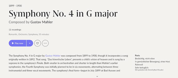

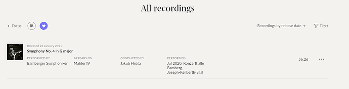

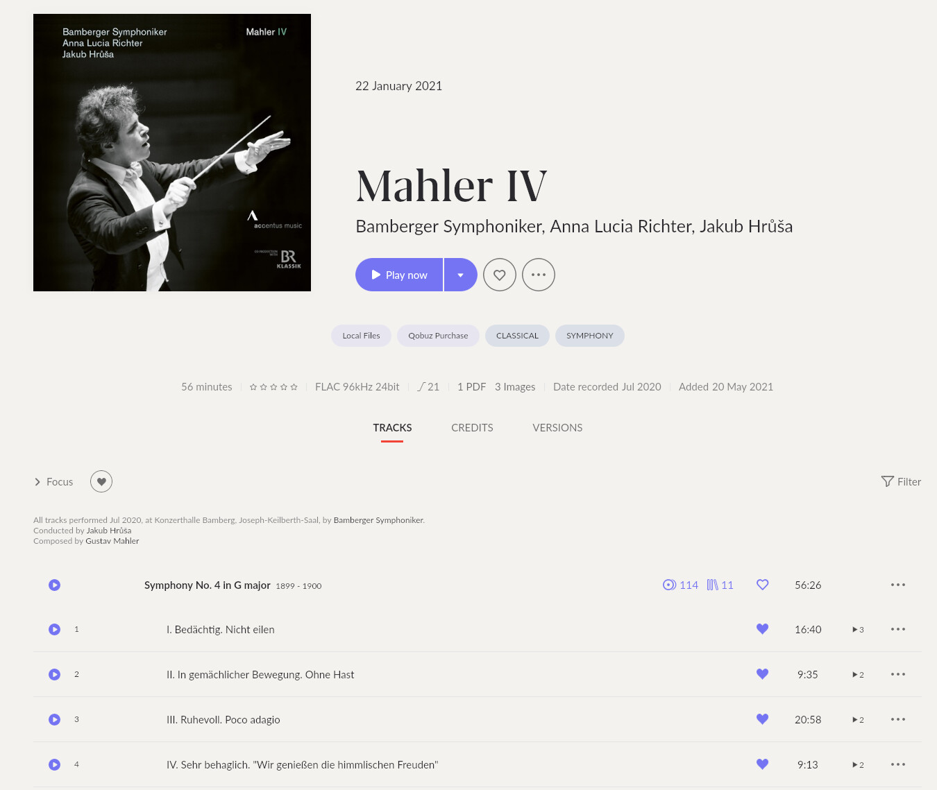

I’ve found that the trick is to just :heart: the tracks themselves in the work’s performance, i.e. the actual recording of the performance. That does not make the composition itself a favourite.
So, for example, here, I have favourited this performance of Mahler’s 4th by marking the tracks, but not the composition:
Doing this does not make the composition a favourite:

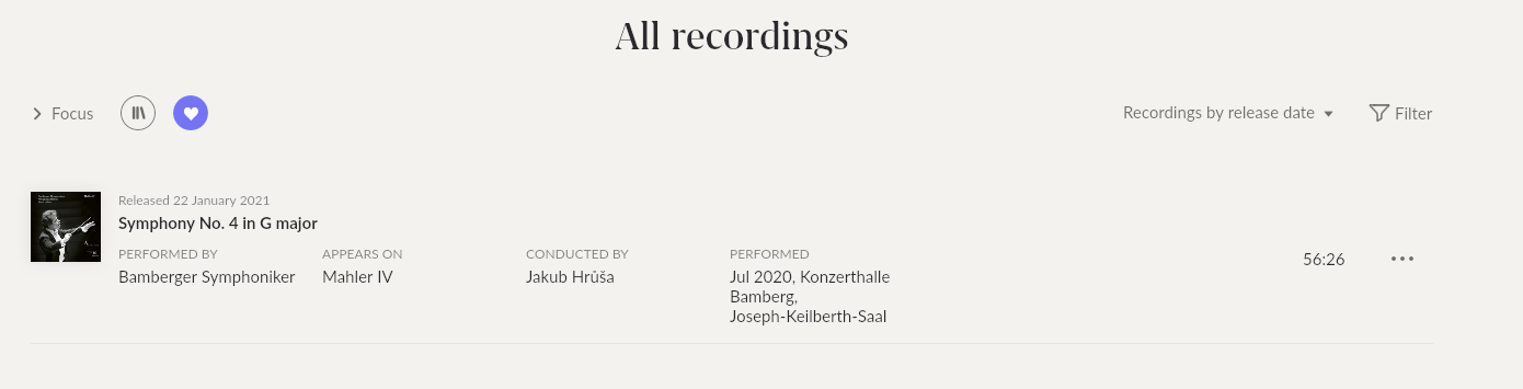

It also allows the favourite performances to be selected on the composition page:
The drawback to this method is that each track in a composition must be marked as a favourite, it is not possible to select multiple tracks and apply the :heart: with one click…
Thanks, that helps. I don’t mind marking the individual tracks. Now what about my Mussorgsky problem? Any idea what causes it? I have a feeling it may not have anything to do with my tagging.

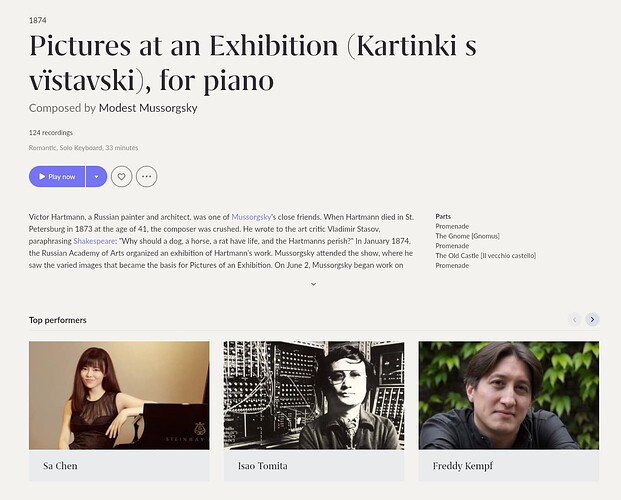

The problem is that the source metadata has not allowed Roon to recognise the Mussorgsky as a single composition. If you have this album as a local set of files, then you could group the individual parts into a single work and tell Roon that it is this one:
At the moment, the list of recordings given on this page does not include the Andsnes performance, because Roon has not made the connection.
You need to have local files to form the parts into a work - we can’t do it for streamed albums unfortunately.

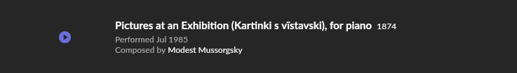

Edit: I’ve just bought this album from Qobuz, so now I have local files that I can edit the metadata. Before editing, The composition was not recognised:
I then edited the files (using Mp3Tag) to add WORK and PART metadata. The last step was to edit the Metadata Preference for the album in Roon to tell it to use the file data for multi-part composition grouping. That got the composition properly recognised and the performance added to the list of recordings on the composition page…

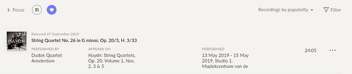

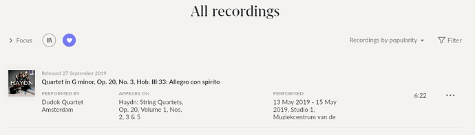

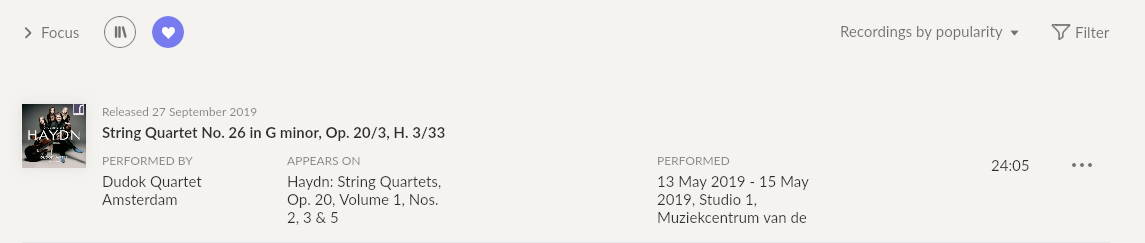

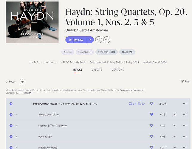

Have you tested if favourite performances can still be selected in the compositions page, if only one track or part (say the first track) has been hearted? If so, that would make the marking of favorite performances of all types of works easier…
Edit: I just tested this, using Haydn’s Op. 20/3 string quartet as example… It works, marking only the first track or part of the work. It still can be selected on the Compositions page as ‘hearted’ or liked… But it will identify the hearted part, and not the work as such. If all movements are hearted, though, the work as such is recognized as ‘hearted’ or liked…

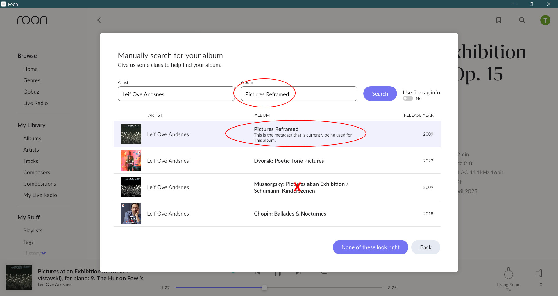

In case others are reading this and are having the same problem. Roon has two versions of this album in its database. You need to search on the album title “Pictures Reframed”.
Why this title is on the back and not on the front I have absolutely no idea:
You can set the title to anything you like afterwards if “Pictures Reframed” does not work for you. That seems to have been what the cover art designers did. All composition hierarchies should then be correct. They are for me.
Much appreciated, that solved the problem.
