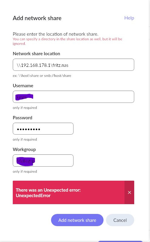

I want a second,separate location for the Roon backup for added data .security. Primary setup is simple with a backup location in the Roon folder on the NAS which is backed up daily as a whole.
Now with the Roon server running on the the NAS (Linux based I believe) I cannot connect to a windows network drive that is attached to my fritzbox.
I made sure that in the fritzbox all permissions, passwords etc are correct and I have no issues connecting to that drive from any of my 4 windows machines on the network.
Now here I try to set up a new network share for the backup of the roon database using the interface Roon provides.
I tried using the windows syntax or the linux smb syntax to connect, but nothing. I always get at first the ‘can’t find network path’ error and then some when I add the network credentials.
This was never an issue when I ran the Roon server on my NUC.
Any help is greatly appreciated
