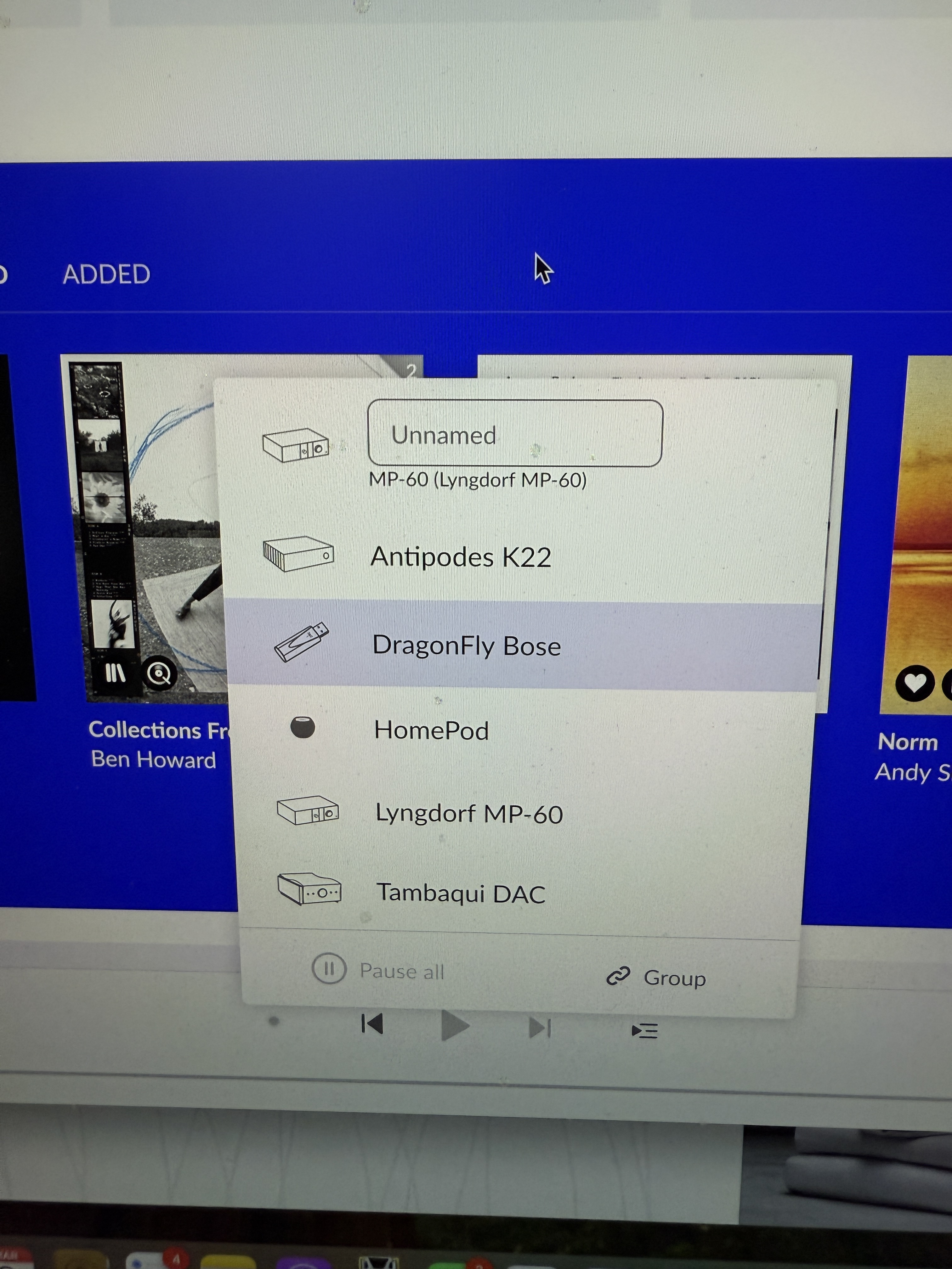

I have a Tambaqui DAC and LOVE it! However, Roon can no longer “see” the Tambaqui as a stand-alone product so I am no longer able to compare relative to how it sounds connected to my Antipodes K22 player/K41 server. I have an upgraded ethernet cable so would like to see if it somehow sounds better. FWIW the US Distributor for Mola Mola agrees with my las impression that a good stream delivers better sound than NOT using a streamer. I will create stand alone post to get some help relating to Roon’s inability to discover my (Tambaqui) Network DAC.
I’m sure you’ve already done this, but just to be safe, I invite you to check the following.
In the Tambaqui’s configuration, you need to select one of the available presets and set the Source input to “Network.” At this point, Roon should display the Tambaqui as an audio device.
I have a feeling that the Tambaqui’s internal streamer board isn’t as straightforward as it might seem.
The internal configuration screen, accessible by using the Tambaqui’s IP address on the network, shows an interface that strongly reminds me of a streamer board from the Swiss company abcPCB, which later became Engineered and was recently acquired by CH Precision. This board is the foundation of products sold under the Wattson Audio brand. Unfortunately, their website has been unreachable for some time. https://www.engineered.ch/
Filtering the network signal with galvanically isolation, the tambaqui with its network input sounds superlative and leaves no reason to try using external streamers, with the only limitation, obviously, being that it functions as a Roon endpoint.
Thanks very much, and I appreciate greatly your advice. To answer your question as briefly as possible, yes, I have of course selected the network output, and there was unfortunately no recognition by Roon of the device. And for what it’s worth, previously, even when I had my output selected to my preferred AES cable the DAC always appeared. Presently I have a USB cable attached as well, though my preference is to use my AES cable as it seems to sound nominally better.
As an aside, I did email my contact at the factory so we will see what if anything they can advise.
Just a quick shout out to those who tried to help me with my issue. I wanted to let everyone know that I identified the problem.
I disconnected all the cables from my DAC, moved it into the office where I had a couple of switches and some known, good functional Cat 6 cables and lo and behold, the Tambaqui appeared on my Mac as an endpoint.
This confirmed that there was no issue with Roon and no issue with my DAC. Instead of the culprit has to be with either the switch in my listening room or perhaps the cable that went bad. Now we know!
So we can consider this case closed.

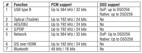

Do you have any experience or advice on the I2S vs USB inputs of the Tambaqui? I am using one with a HiFi Rose RS 130 via I2S and as you know the Mola Mola can’t decode DSD over that input. I could switch to usb for dad files but it’s a bit of a pain and difficult to compare the two directly since one has to switch the Mola and rose in order to test.
Just curious if you received any guidance from Bill or have ever tested.

I definitely appreciate the Tambaqui is equally at home playing either format, I just happen to have a bunch of purchased music that is in DSD format (files on a NAS) so I still want to be able to play those. The easiest way would be to connect my Hifi Rose via USB and forget it. I just have this suspicion that the I2S connection is better so I dont want to ‘compromise’ all my music listening for the sake of the relatively infrequent times I play DSD files. (as you know the Tambaqui cant play DSD over I2S) So its more about the hardware interface performance, than the file format - if that makes sense.

Unless Tambaqui has some very odd implementation of USB (or Rose some limitations of what it will play to Tambaqui over USB; Rose software is quite notorious for being half-baked) there isn’t any reason for I2S to be better in any way; it’s a terrible choice for external connections. Give=n Mola Mola’s reputation for technical excellence I’d just connect it with USB, which is the best available connector for anything properly engineered.

Thanks Robert, unfortunately the Tambaqui only supports DSD over USB and its network connection.
John, my Tambaqui supports DSD with AES via DoP as my Antipodes supports offers support for this. I think that may be unique to the brand and a few others no doubt. I think it supports up to DSD 64. Can’t tell you how it compares to native DSD. Some say the same.
Are you sure? The Tambaqui manual states DoP is only available via USB and network per below:
iScreen Shoter - Safari - 250529141214
Since DoP is packaged as PCM, any connection that supports 192/24 PCM should also support DSD64 DoP - unless of course there’s some screw-up in the implementation. The manual may be referring to DSD256 support, although that would be weird.
