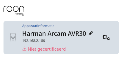

Related to the Arcam Solo Uno, RAAT was recently implemented (although not yet certified) on Arcam’s new AVR’s, as you can see in this screenshot from Roon connected to the AVR 30 which is currently in-house for testing. My understanding is that the code base is the same as the Solo Uno.

Are you sure? No mention of Roon on the specs page or in the v0.82fw release notes (UK).
About the AVR30 I’m very sure - whilst typing this I’m streaming with Roon to this particular receiver. That’s where above screenshot came from. My information about the Solo Uno and Roon is from a local distributor. So it’s possible it’s not correct, but unlikely.
The Arcam HDA SA30 Amp is supposed to be Roon Ready according to the blurb, not seen anything of it in the wild yet so I wonder if its been delayed because they are awiating RAAT certification?
