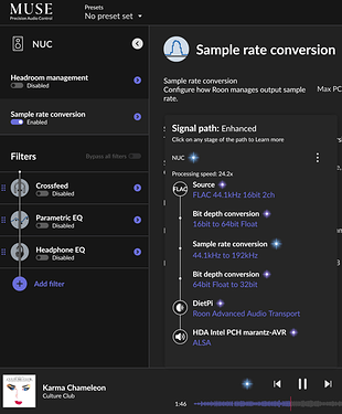

Have you set channel mapping in Roon correctly? what are the device settings in Roon for the Marantz. It may not supports 32bit via HDMI for Multichanel so try and reduce to 24bits. It does feel like bad EDID info though so its only reporting back 2.0 channel support. But it shows nothing at all on the inputs for multichannel odd.
I don’t understand your signal path. As far I know there is only a PCM (96 kHz / 24 bit) Surroundmix version of Fleetwood Mac Rumours. But that is not what your are showing

That could be the issue! According to the Marantz specs it only supports up to 24 bit, but I did have it working with 2 channel at 32 bits. I’ll try multichannel at 24 bits tonight.
Disappointingly, after changing to 24bit, either 5.1 or 7.1 breaks the NUC playback. Changing back to 2.0 doesn’t work by itself, I have to restart the NUC.
Just to say I tried everything, I also tried 16 bit 5.1 but still failed.

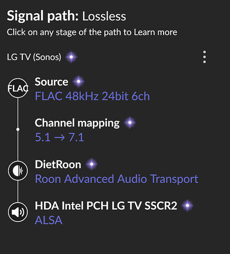

I have been happily using it multi channel on DietPi for about 11 months without issue.
Having recently had a number of kernel and other Updates I will try it again tonight after we finish watching TV , as I have some new multi channel music I want to listen to anyway :grin:
(My HDMI Device is Sonos and it is limited to 24/48)
