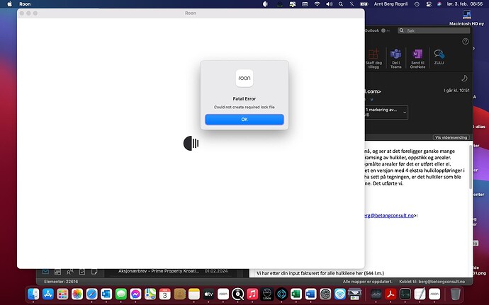

My Roon Core on Mac does not start now suddenly???
@Arnt_Berg_Rognli, have you started the Roon Server application, not just the Roon application?
Yes. This is the screenshot I get now. I have never had this before.
Does this page help, @Arnt_Berg_Rognli ?
I have done this a lot of times, but it does not help
That screenshot shows that there is an error - a problem with the Roon Server. Try quitting and restarting it. If the error persists, then download and reinstall Roon to see if that fixes it. If not, come back here and the Support team may be able to advise further.
I have done this, but the problem is still there
OK, then the Support team will need to get involved. They don’t work weekends, so I’m afraid it won’t be until next week that they will respond.
I also get this message when I try to open the ROON app??

Hi @Arnt_Berg_Rognli,
This error indicates there are two instances of a Roon process attempting to run simultaneously - the MacOS lock file is preventing the second instance, visible in the screenshot, from running.
Try simply rebooting your machine - it’s unclear if you’ve tried this from the steps above. If that doesn’t work, then try this. Ideally, you have a Backup you can restore.
  • Exit out of RoonServer
  • Navigate to your RoonServer’s Database Location
  • Find the folder that says “RoonServer”
  • Rename the “RoonServer” folder to “RoonServer_old”
  • Reinstall the RoonServer App from our Downloads Page to generate a new RoonServer folder
  • On the Roon Remotes, press “Use another Roon Server” and connect to the new database
Please keep us posted if this persists. Thank you!
Hi Connor. This solved the problem. Thank you!!!
