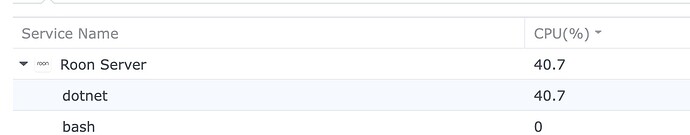

This problem happens when I play music from my Mac with the system output, when I stream music to a device on my network (Fiio SR11 for instance). The music stops or pause randomly, a pop-up appears ā€œwaiting for your Roon serverā€.
In the Synology task monitor, The Roon process maxes out one core of the CPU, sometimes 2 (specifically the dotnet subprocess).
After a moment (from 1 second to 2 minutes), doing nothing the music restarts or I can press play music again.
From my perspective, I really can relate the dropouts to the CPU occupation. Screenshot taken just now, Roon is only streaming a MP3 320 to the Fiio SR11, no Muse adjustments.

So your system is freshly setup and is still analyzing the library or you set it to analyze on demand? In any way, a running analyzing process will occupy your CPU what you identified as the root cause of your issue. Let the analysis process finish with your library before listening will remove the CPU load generated by it. Set both related settings to off for testing might give you insight too about a potential impact on your issue.
PS: With only two cores on the CPU, Roon playback, Roon analyzing and the rest of your NAS system running too, potentially with an active antivirus that wants to scan files on access, you might reach the limits of your CPU quickly.

Your NAS OS and its services get updates too that may impact performance. Roon may demand more performance after certain updates. The issue seems related to file access which may trigger quite some activity not only from Roon but also from the NAS and its services. We don’t know the details of your NAS setup, what services might be running and so on. If the system runs out of resources this will impact running processes and as far as the CPU goes, it has only two cores – so it might run out of resources more often (quicker) than a 4 core CPU. If you happen to have a decent PC/Mac (more potent CPU than the NAS) you can use as Roon Server temporarily to test, you can use that to compare to (see if you run into the same issue).
Yeah, I just shut down a docker container which seemed to be faulty and now it seems to be working without any hicups, but still reaching high CPU occupation regularly, I’m gonna think about moving to a more powerfull server dedicated server for Roon maybe.
