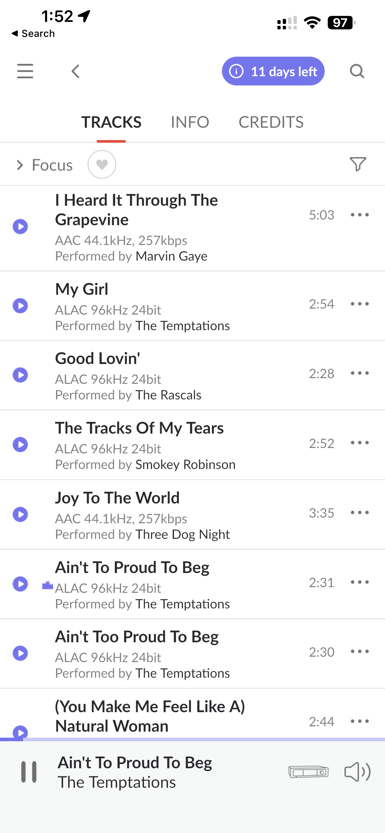

The first track ‘I Heard it on the Grapevine’ the M33 just skips, click it, and a quick flicker and it jumps to ‘My Girl’ and plays that song.
Like wise ‘Joy to the World’ is skipped and jumps to ‘Ain’t Too Proud to Beg’
The songs do not seize the M33, it just jumps them.

Just installed them and rebooted the server and did not fix the issue, BUT think you are on to something.
  • AAC is the issue files
  • AAC on Synology needs extra support beyond the built in ffmpeg

Built the CORE on a Mac Mini. More impactful than I expected. Home Assistant needed to be rewritten to all the new entities, after the integration was authorized, etc…
The NAD M33 plays all of the files
My hypothesis is the CrystalGipsy was correct on the ffmpeg and the Synology Package.
