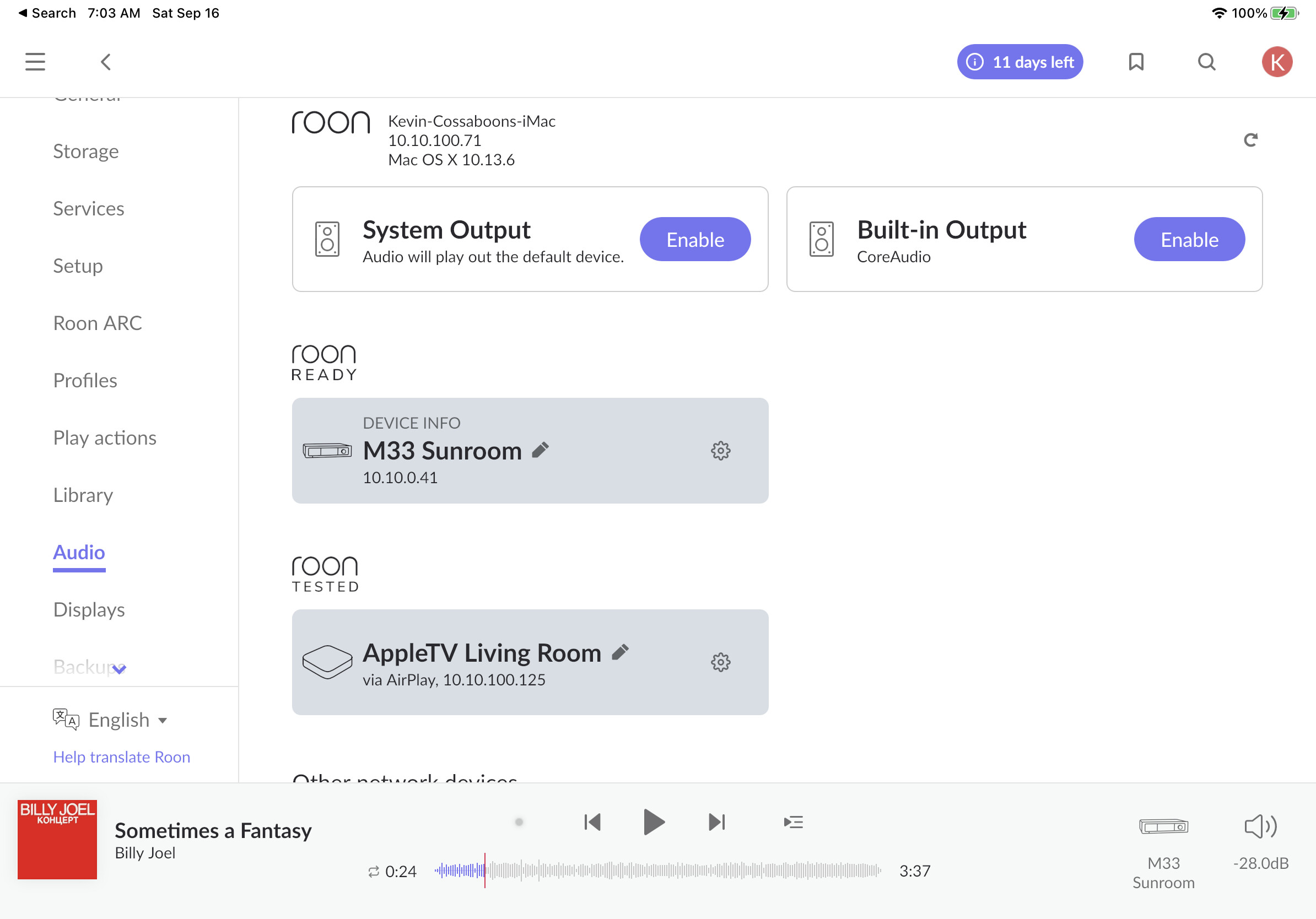

Apologies for repeating myself, but from the screenshot it seems that the M33 might not be in the same subnet as the AppleTV and the iMac. The IP address is of the M33 is 10.10.0.xxx, whereas the AppleTV and the iMac have 10.10.100.xxx.
Of course you could have a very big subnet :smiley:, or NAS and RoPieee are also in 10.10.0.xxx, which I can’t tell from the screenshot. If that is indeed the case, then please ignore this comment.

Thank You for double checking. The network is 10.10.0.0 /16 so it is a VERY large network just for easy of numbering. 10.10.0.x are network appliances, 10.10.10.x are services (like ROON is 10.10.10.2) then the clients ‘should’ DHCP into 10.10.10x.x

Thank You but it is the same subnet 10.10.x.x is ONE subnet with a 16 bit mask.
