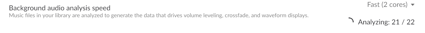

I have see multiple posts about this over the last few years and they all seem to be closed without a solution. It has been happening on my system for a couple of years and otherwise the system is working fine. But I finally decided to post. The number changes sometimes 4/5, 18/19, 21/22 - but there is always one left with the spinner that never finishes. How can this be fixed?

Screen shot from just now:
