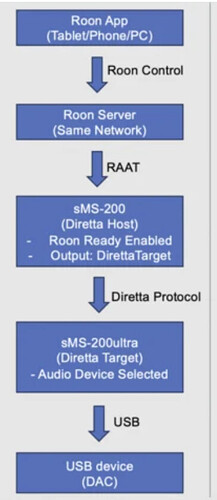

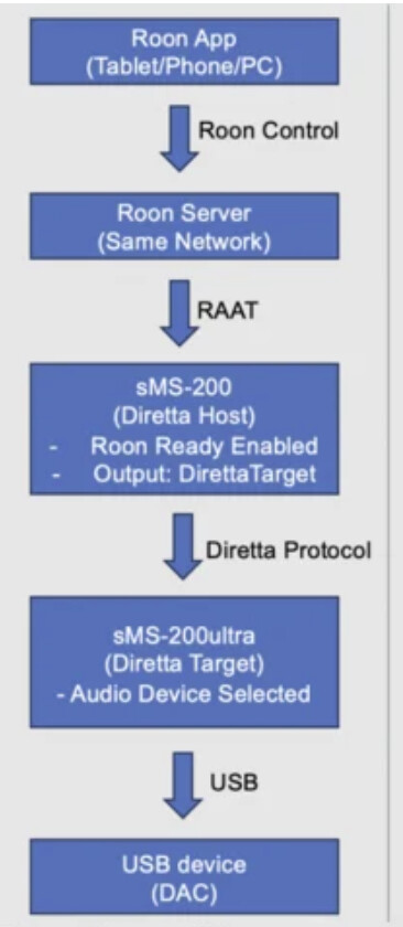

My sMS200 + Diretta setup:
Roon-Rock server >> RAAT >> Diretta HOST +Roon (sMS200) >> Diretta Protocol >> Diretta TARGET (sMS200 Ultra +sPS500) >> USB >> DAC
It’s a real plus for the SQ >>> thanks SOtM !!! Well done !!
