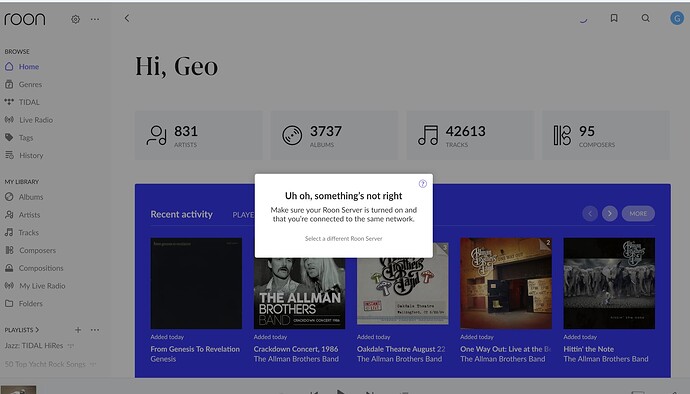

Thnx for your reply. I rebooted and was adding files this morning (at about 9:15 am PST) and things were going well for a time and then Nucleus stopped importing and saw this screen – it was importing “From Genesis to Revelation” by Genesis at the time.

Hi @Geo_Alder ,
It looks like there was a lot of analysis work happening around when you reported the issue. If you try to edit your Roon Settings → Library and set both On-Demand and Background Audio Analysis to Throttled or Off, do you still notice the issue?
Thanks for getting back to me. I have reduced the size of my library (now done to approx. 5000 albums) and now things seem to be working fine.
