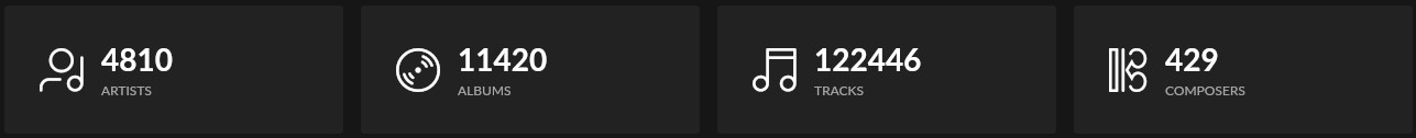

Is that 123,500 albums or tracks when you state 123,500 MP3 files?
And what are your settings in library for file analysis etc?
There are ~123,500 mp3 files on the NAS.
Here’s what the Roon Home page (which suddenly I able to actually access) says:

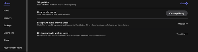

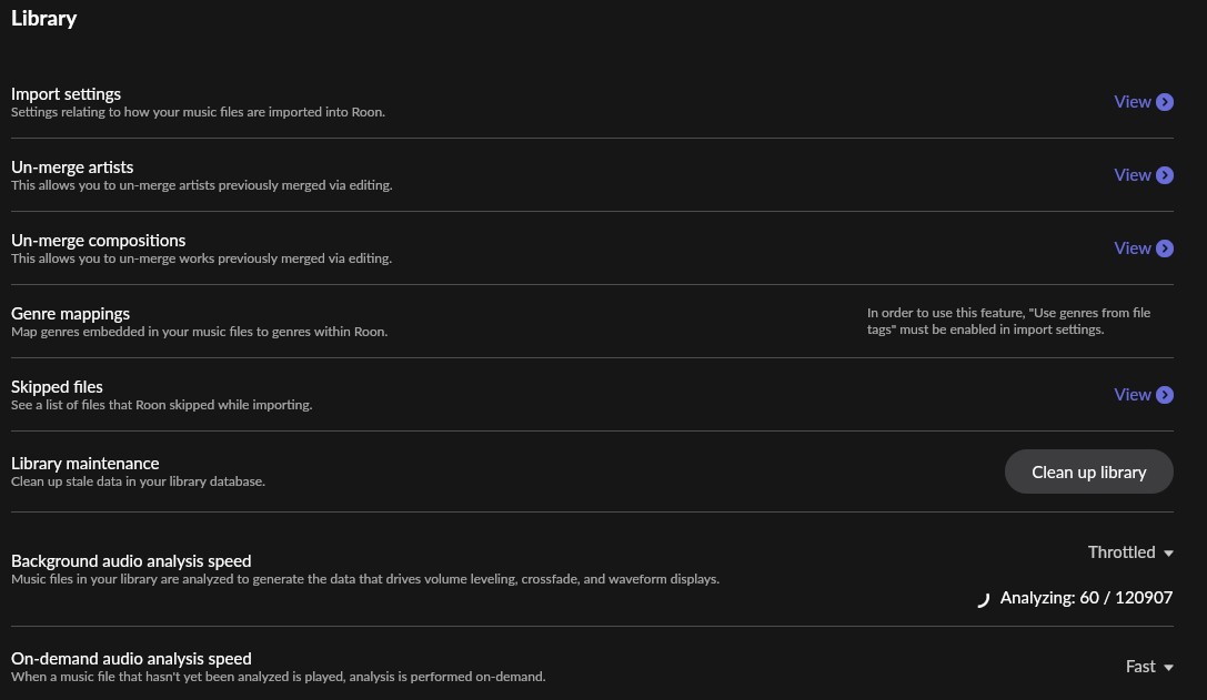

Here are my library settings:
But note the important point above… all of a sudden, after probably 12 hours, I actually have access to Roon and am able to listen to music. No more endless animated icon. Bizarre.
That’s pretty quick for that amount of files. Where it says Throttle, you could turn that to OFF and stop any impact on your system, and then turn it ON when not using the system, like overnight when sleeping.
Personally, I keep the analysis OFF, and just go with on-demand, which means it does the analysis when you start playback, assuming it hasn’t done it already. Depending on your CPU power, it is a slight delay, with my i9 there is no delay.

I can’t use the Roon UI to turn the throttle and analysis settings OFF because I cannot get past the animated icon.
Are these values written into a config file somewhere on the filesystem? And if so, can they be edited manually in a text editor?
