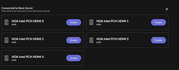

I don’t use them but this is how the NUC shows up for HDMI on ROCK
Thanks Mike that was exactly how it showed up for me.

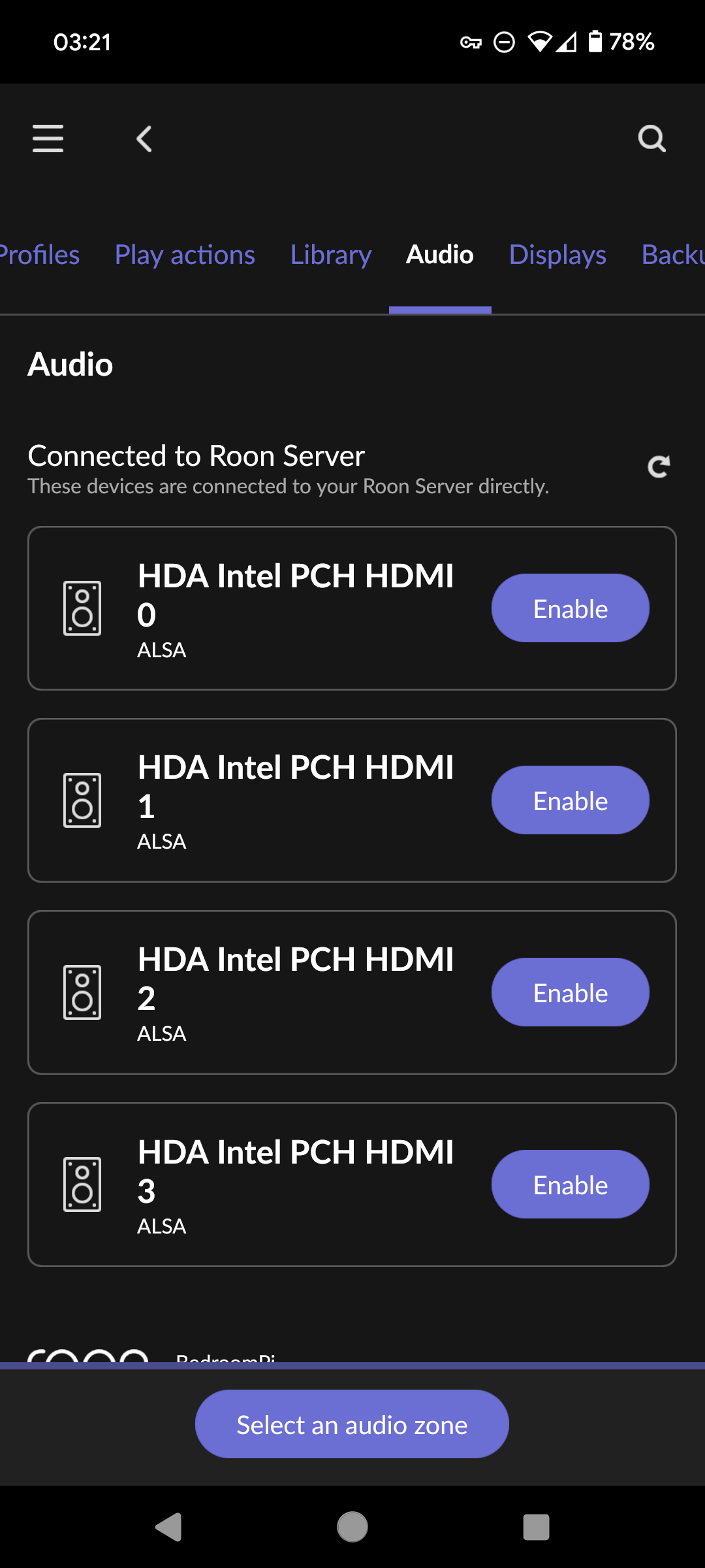

I was away on holiday but I am back now and my DietPi looks like this
I think only HDMI 0 works on my Sonos ARC and I am unsure what the other devices do

My HDMI endpoints (unused) on Dietpi running on a NUC11TNHI7 look like:
I’ve never tried using any of them. My AVR is too old and does not support HDMI :thinking:
