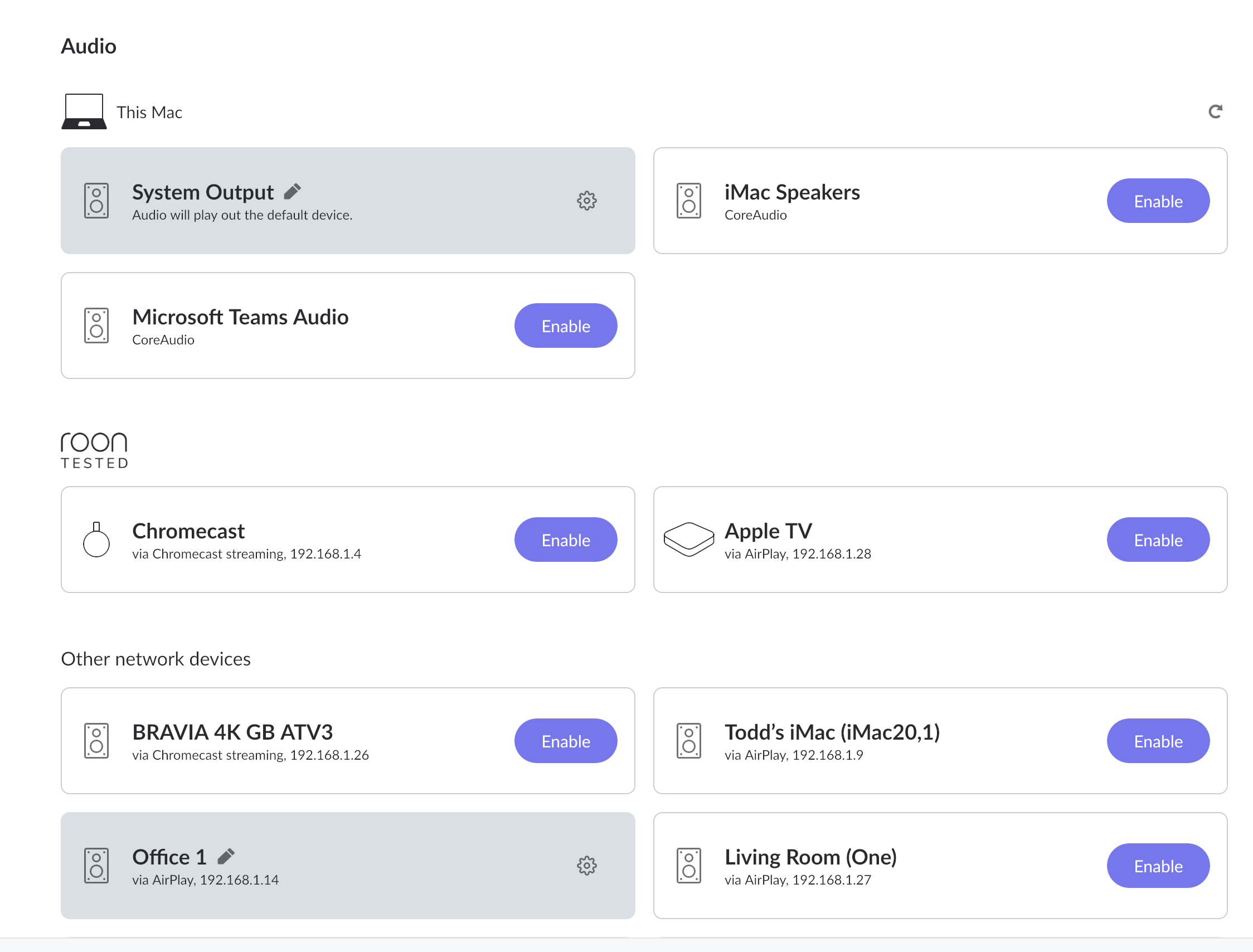

System Output routes audio via the OS mixer; you need to enable Core Audio on the Mac.
Also, please show the Signal path and device settings.
The Mac isn’t seeing anything connected to USB to output to. Nothing for the converter shows up in Roon there at all. What zones are you actually playing to as it’s not going to work without the device showing up. I think your using a route that seems incompatible as Roon isn’t seeing your DAC at all via the converter. If it did it would show up as a device to enable Roon to play to.
How do I enable core audio on osx ?
Core Audio is listed; it looks like you’ve renamed it “iMac Speakers”.

There are three reasons in your signal path, why can’t get DSD:
  • Headroom adjustment
  • Parametric EQ
  • AirPlay
For getting DSD (also for DoP) you can’t use any DSP and you should use an USB DAC.
The source file is PCM not DSD. Moreover, the endpoint is Airplay not Core Audio as discussed.

My DAC (Gustard X16) is NOT showing up anywhere. It is connected to the Inca via a Douk Audio converter to the Gustard via I2S (HDMI) cable

Incidentally, you won’t see the DAC in Roon when connected to the U2 Pro; Roon will only show the U2 Pro.
In addition, I note that this uses the XMOS chipset and requires an ASIO driver (Windows), so it is possible native DSD won’t work with your iMac. DSD over PCM (DoP) should work.
I just ci=onnected the Gustard to the Mac w, bypassing the Douk…the Gustard now shows up in Roon.

After bypassing Douk with usb from Mac to Gustard
