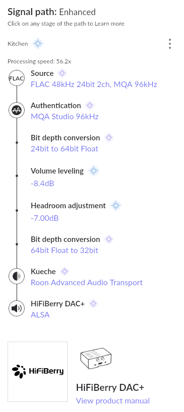

Here are the signal paths of the three zones individually, ungrouped (Zone “Bath GF” is the mono zone)
