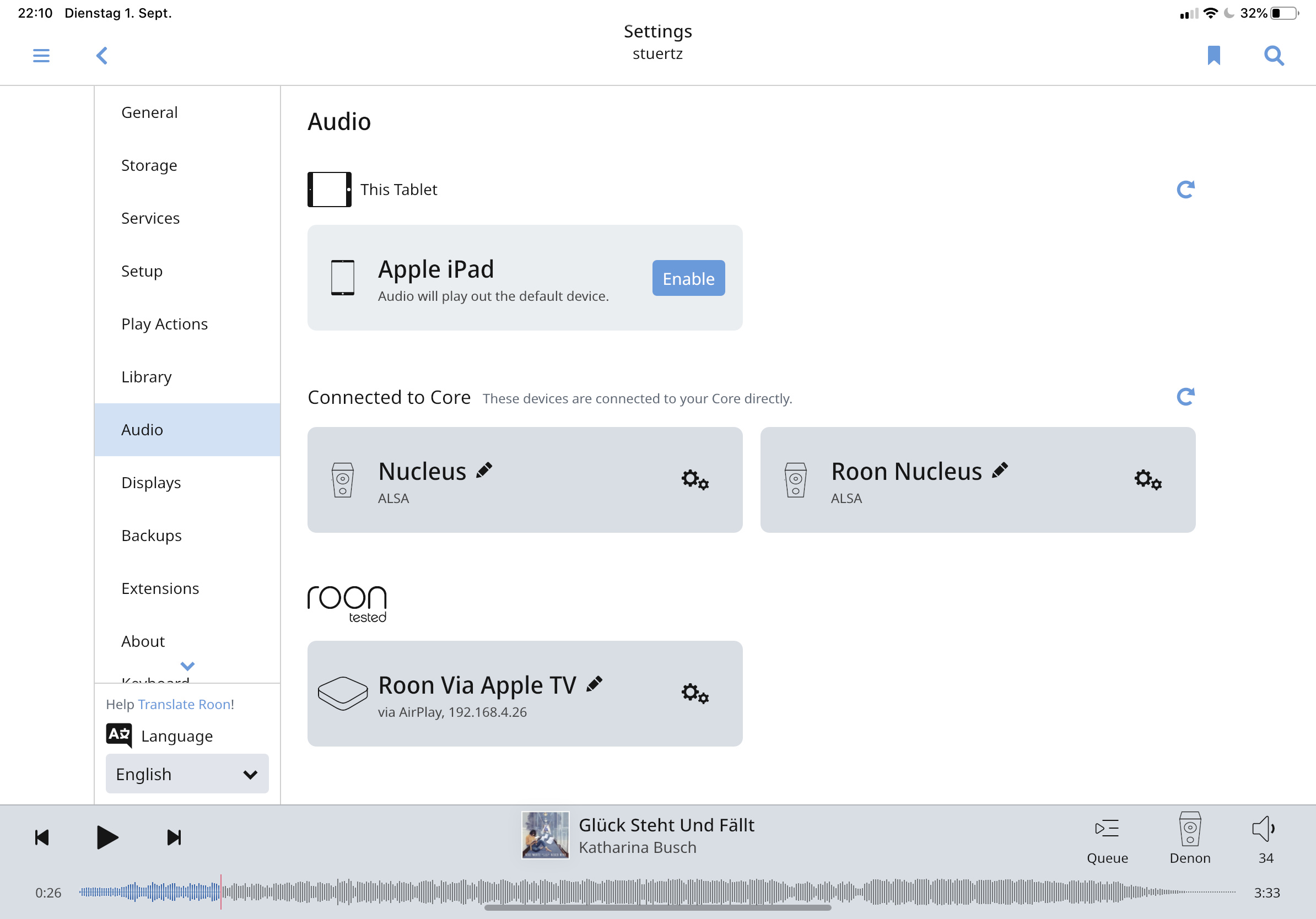

In that second screenshot, your Nucleus is just showing two audio devices (which you’ve labelled Nucleus and Roon Nucleus).
When I look at my ROCK/NUC - I’m seeing 6 devices (the Denon device has been renamed from the default “HDA Intel PCH HDMI 0” device)…
Now it may well be that Roon Labs have disabled the extra HDMI channels in the Nucleus BIOS, so let’s wait until the official Support team weighs in.
In your third screenshot, you have DSD Playback Strategy set to use DSD over PCM. I’m not sure that this works for Denon devices - you could try setting to “Convert to PCM” to see it that works for you.
Also, the Denon AVR X4000 has no MQA capabilities, so that should certainly be set to “No MQA Support”.

Yes, this is expected behavior, extra HDMI ports are hidden on Nucleus. The two Nucleus and Roon Nucleus ports are indeed the HDMI ports as well, you can rename these to HDMI 1 and HDMI 2 if you’d like.
