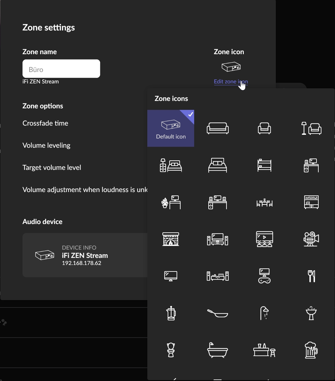

I used the iFi stream via USB on a Lyngdorf MP-40. Because of that, Roon changed the zone icon that display the iFi stream to an icon that displays the MP-40. Now I use the iFi stream on another preamp, but this time with digital coax. For this reason, I can’t change the icon to the new preamp. However, I can’t change it back to the default that displays the iFi. The default icon is still the MP-40. There seems to be no way to break this connection.

When I first setup the iFi stream, it had the icon that can be seen in the screenshot (on the top). Then I attached it via USB to the MP-40, and it got the other icon in the screenshot (on the bottom).
Now I unattached it from the MP-40, and I configured the iFi stream to use Digital Out instead of USB (which has to be done because the iFi only supports one of them at the same time).
I then attached the iFi to a DIFFERENT PREAMP (Nubert nuControl 2). Because I now use a Melco N100 with the MP-40.
But I cannot get rid of the MP-40 icon for the iFi stream.
That’s because the “Default” icon is still the MP-40 icon and NOT THE iFi icon.

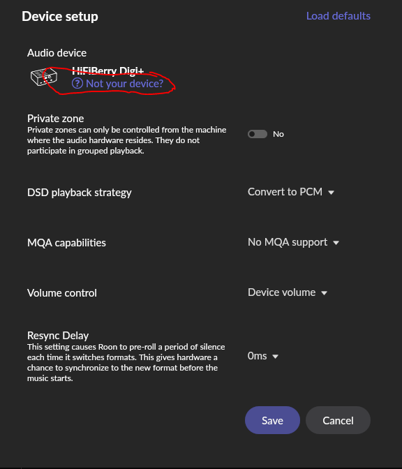

Like Martin said try looking in “settings/audio” in roon:
Click the gear icon next to the device you want to change the icon for and select “device setup”:
Then look for the blue text next to the Icon that says either “not your device” or “identify your device”:
Click the blue text a few time until the “find your device” dialog comes up and then assign what you want from the list. This should set the “default” icon for the zone to the device icon.
If this does not get rid of the secondary icon, you may need to disable the device and/or zone then re-enable it or even reboot the core to get it to see the change?

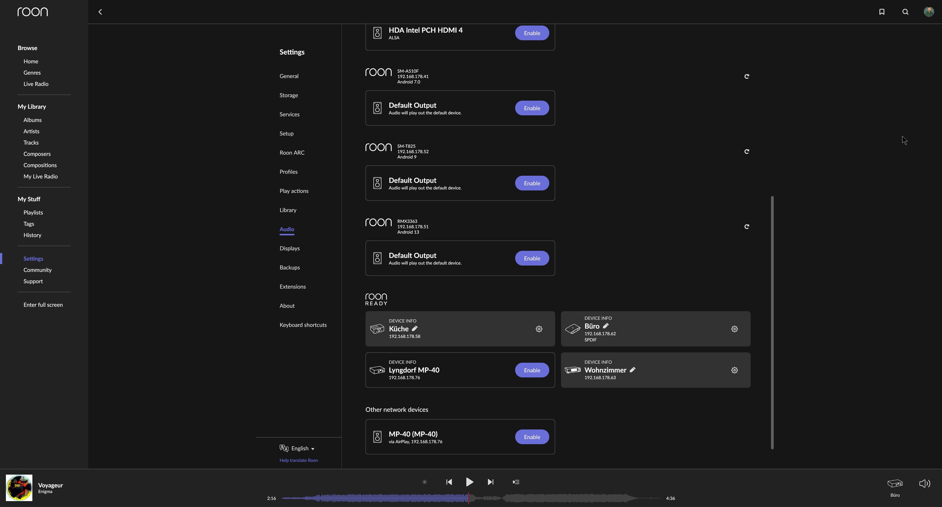

It’s unclear if you followed the suggestions previously provided. Please share a screenshot of Settings > Audio, with all endpoints connected, and powered on.

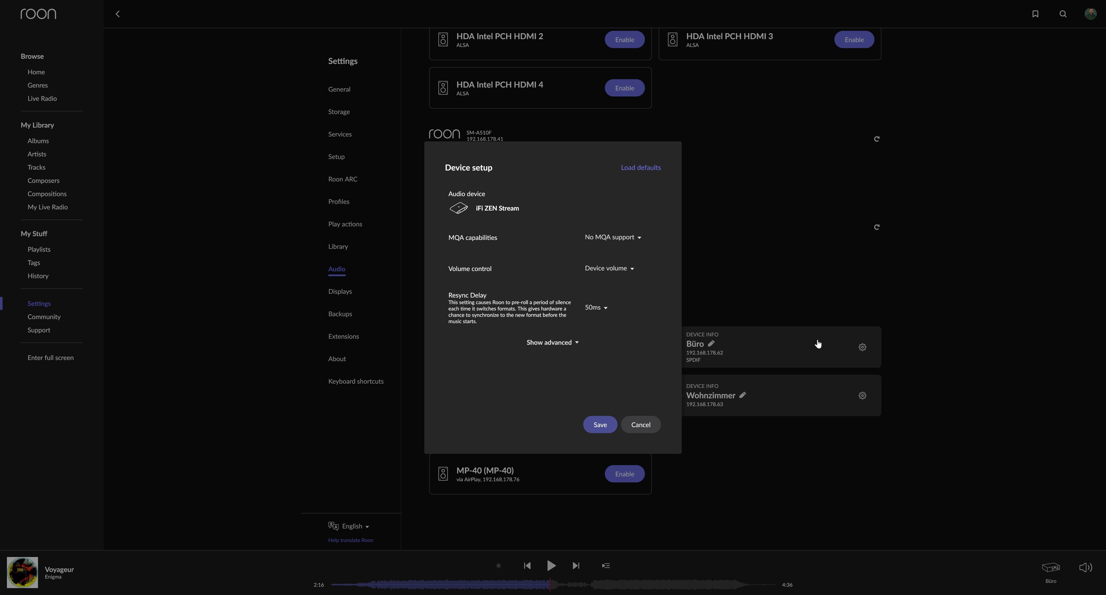

This is a screenshot of my Settings → Audio with all endpoints connected and powered on (two screenshots because there are a lot of entries)
The device with the issue is labeled “Büro”. In that screenshot, the icon is as it should be.
However, as you can also see on the bottom right of each screenshot, this is how Roon now displays the icon (it’s the icon of the Lyngdorf MP-40), and this display can’t be changed.
Loading the defaults in the device setup normally brings back the original icon. But as you can see here, I already did that. The icon is back, but ONLY in the device setup menu. NOT in the other displays. And as you can also see, THERE IS NO MORE A LINK to the MP-40. But the icon of the MP-40 is still used. It’s stuck.
The zone icons isn’t the device icon, so I would suggest choosing and alternative icon, saving, and then coming back to that screen What do you see?
Also, did you go to device settings, and use the Identify device link?
Changing the zone icon, saving it, and then changing it again gives me the MP-40 icon as the default. There is no other device icon than that (the others are furniture etc.)
As you can see on the screenshot, if I go to the device settings, there is no “identify device“ link because Roon already correctly identified it to be an iFi Stream. But Roon does not carry that knowledge over to the zone icon options.
