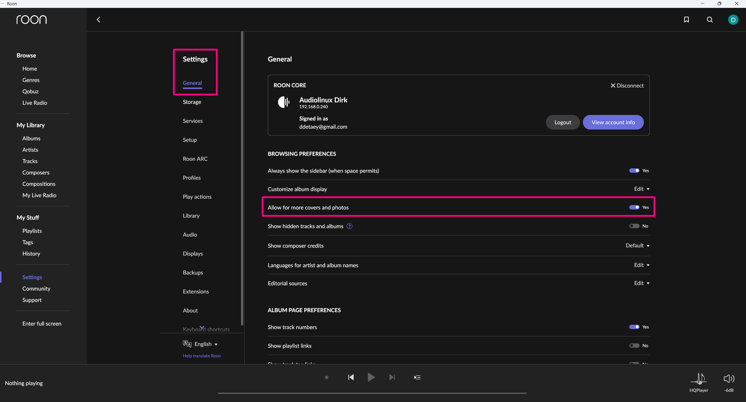

Please check the following 2 settings, ansd see if it helps:
Thanks for helping!
The first setting was as shown in the picture above, the second wasn’t, so I put that on ‘yes’ but it didn’t solve the issue yet.

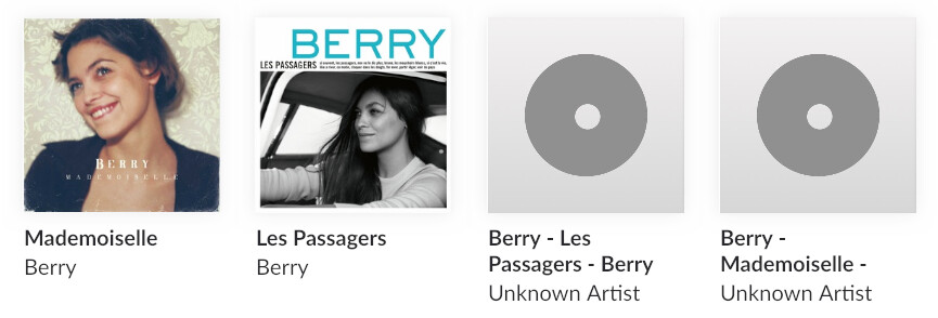

I also further deep dived to see whether I can see any correlation and I think there is some correlation:
In most cases, it concerns a copy of an album (sometimes even 2 copies) while there is only one occurence available on my NAS. Eg:
This CD from Lady Gaga and Bradlley Cooper shows up 3 times in my catalogue. First is correct with correct meta data. The other two are ‘ghost albums’ (don’t know a better name for it)
Here some other examples:

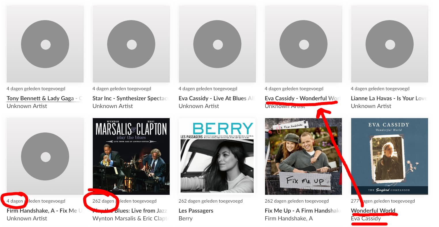

I also notice that in almost all cases it concerns CD’s that I added last. And also the other way around: all albums I added last have one or more ghost albums.
See eg. Eva Cassidy. I added that album 277 days ago and 4 days ago the ‘ghost album’ was added.

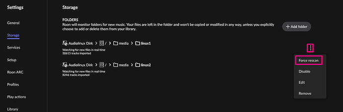

I can only tell you what I would (try to) test), after logging out from your streaming service(s) if any.
  1. Check Settings-Storage to see if you do not have double, or even nested, folders with the same albums.
  2. I would add a new local album that you are 100% sure of, that is not on your storage now, and not in your Roon Library.
  3. I would complete remove all instances from a particular album, preferably for an artist with only 1 album (with correct and ghost version(s)) . Make a backup of the album folder, containing the music tracks to your PC!
    1st Remove the album from your Roon Library, then actually delete the (remaining empty) folder from your Music folder.
    Check on your NAS if you can find any instance of this album (folder), and if so delete it.
check Roon again if all versions have dissappeared.
then copy the album folder back from your PC to your NAS music folder.
Give it 1 to 2 minutes, and check if the album appears in Roon.
If no result force a rescan of your Music storage:
Now check in Roon if you have the correct album, or a ghost album again.

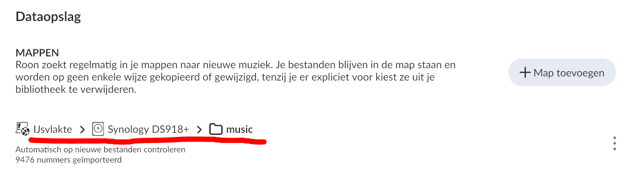

I have only one folder added in Roon:
I checked the folders for nested folders etc, and didn’t find any nested folders or double files there.

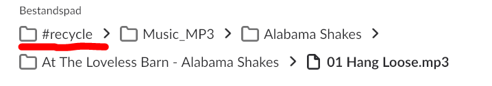

I removed one file from my NAS that has the ghost album issue (Alabama Shakes) and the original album disappears from Roon. But: the ghost album was still there! I tried to play the music from the ghost album and it played! I was surprised, so it must link to an actual music file somewhere on the NAS! So I looked for the file details and this is what it shows:
It links to a file in the recycle bin folder within the music folder! Music_MP3 is a folder on my NAS where I store copies of all albums in MP3 format to transfer them to my phone, car etc. Of course, this folder is not added to the Roon library. I think in the past I accidently added new MP3 files to my music folder instead of the MP3 folder and when I noticed I made a mistake, I deleted these MP3 files. But… .they are still stored in the recycle bin folder in the music folder! That is where the ghost albums are coming from!
So, I deleted the files in the recycle bin folder and all ghost files are gone in Roon!!! :slight_smile:
