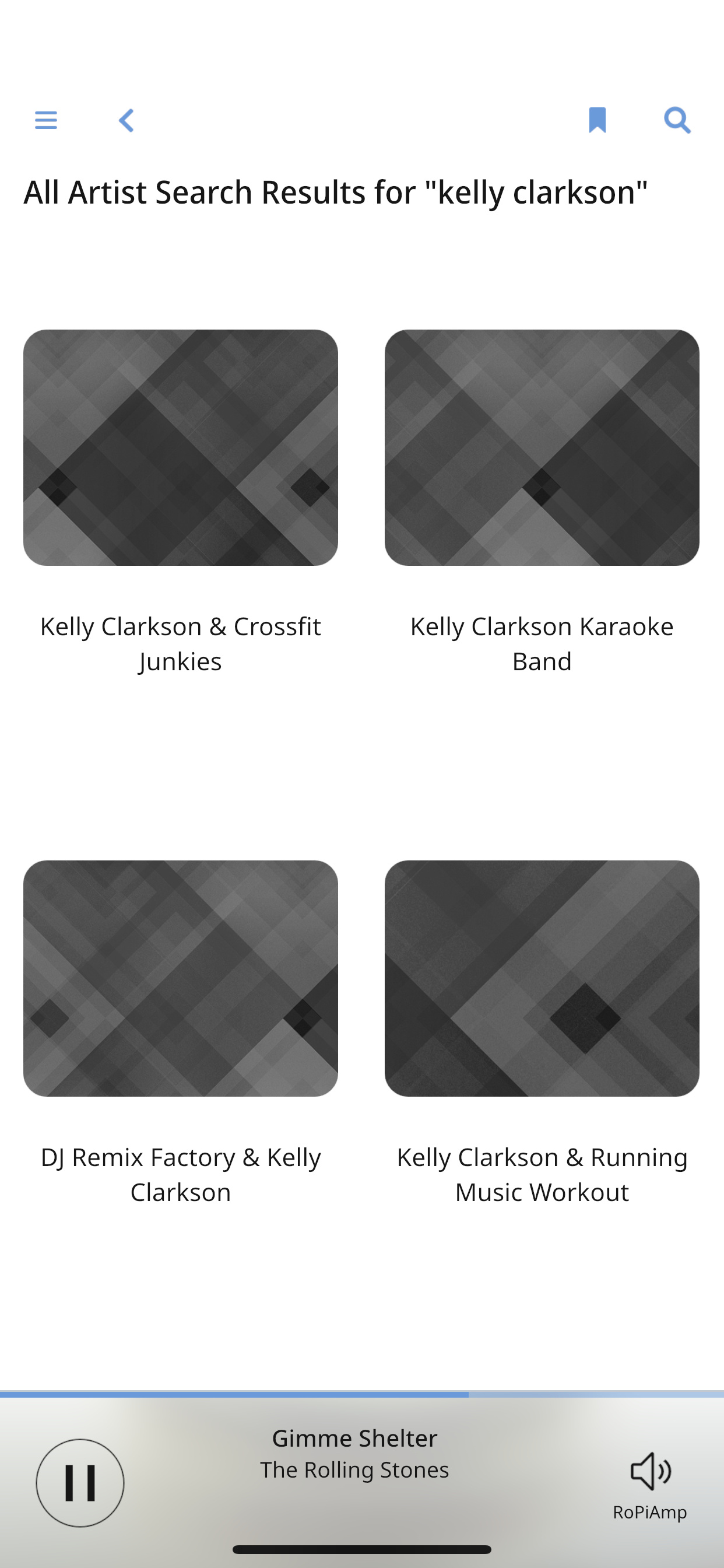

When I search for an artist, I only get results if the artist is in my library. Otherwise I get random albums that happen to have the artist’s name in the title. I’m sure this didn’t used to happen, and must be a filter I’ve set somewhere. As an example, I search for Kelly Clarkson and get a track as the too hit, and even when I click show all artists, still don’t get a hit. Then if I search for a particular song All works fine, and then when I click on the artists name from the track, the full Kelly Clarkson profile page appears.

That makes no sense. She’s not in my library but she still pops up as the top result, and the first in the list of artists.

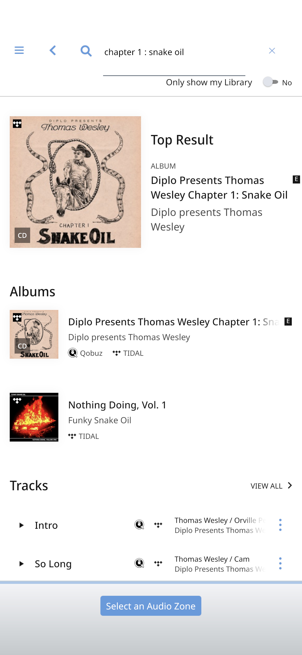

Here’s an example using an artist called Diplo and his new album Chapter 1:Snake Oil. Seemed appropriate for an audiophile forum :slight_smile: hopefully no one is triggered.
  1. search for diplo - nothing
  2. search for the album title - album found
  3. open album and add to library
  4. search for diplo - diplo found, full artist page displayed including all albums, not just the one in my library.
