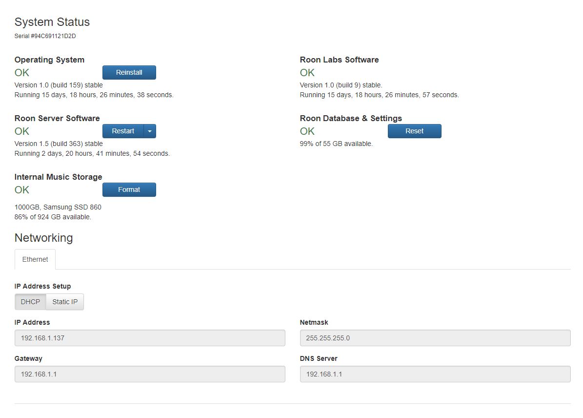

I’m using Nucleus connected to Directstream Jr. via USB. Nucleus and Roon are up to date and Directstream is using latest (Redcloud) driver.
Everything works fine for a while, then at some point the connection is lost, with a sound like lifting the needle from a turntable. Roon seems to keep playing, but no sound. If I reboot the DAC, everything is good again for a while. If I try to reboot Roon rather than the DAC I get strange behavior, like the “play” graph at the bottom zooms back and forth, or the program quickly zooms through my entire queue (without playing).
Everything was OK when I was connected directly to the DAC USB from my computer (as the Roon Core). Also, Nucleus out to the Directstream Jr. Bridge seems OK (though I prefer the USB sound, so want to fix this). So the problem seems to be with Nucleus USB. I did add the Nucleus and Redcloud at the same time, so it’s possible that it is the Redcloud driver, but seem unlikely as no one has reported this behavior anywhere that I can find.
Also, just FYI, I’m using internal storage on the Nucleus, and have tried “resync delay” up to the maximum delay, but the problem persists.
Please let me know if you need any further info, and many thanks for the help!
