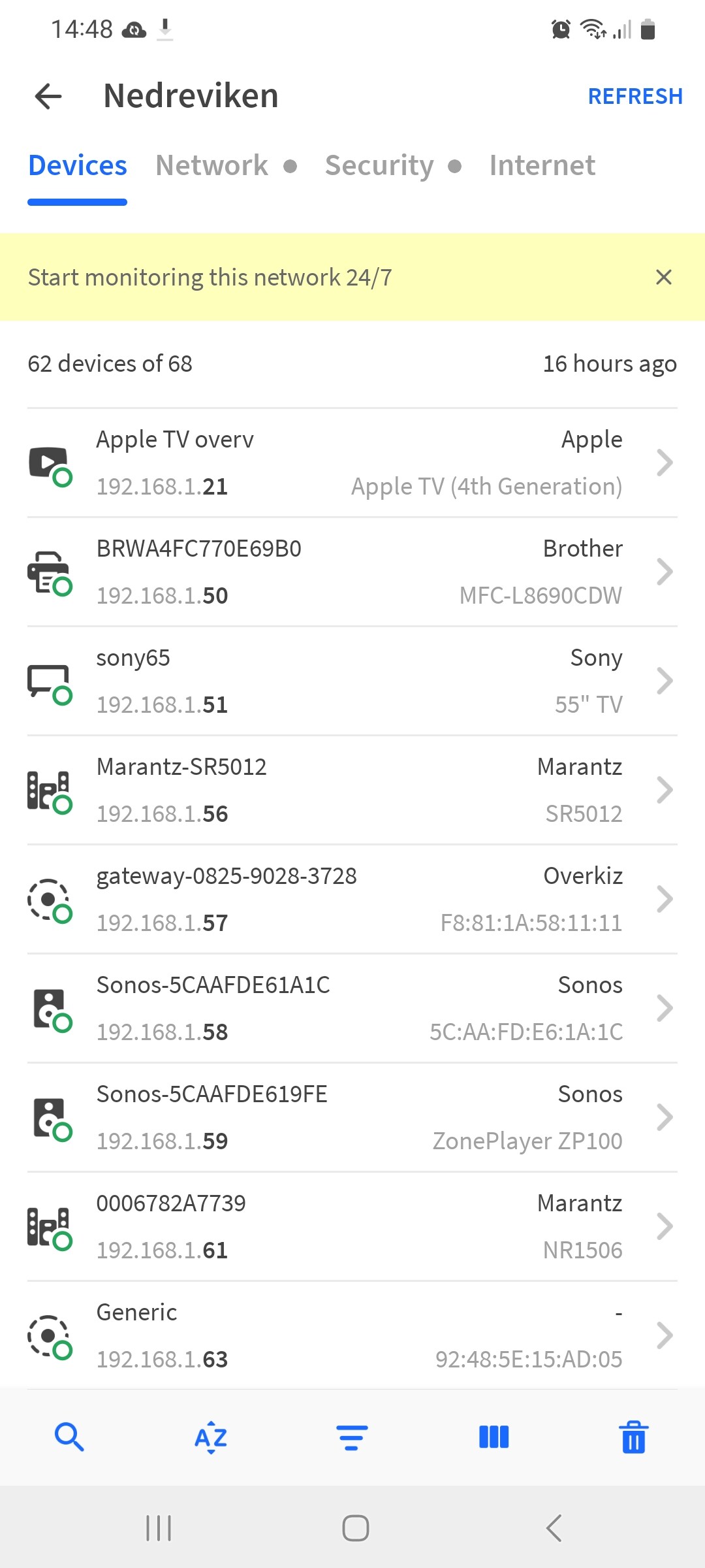

Please install this app on your galaxy:
Scan your network and share a screenshot.
