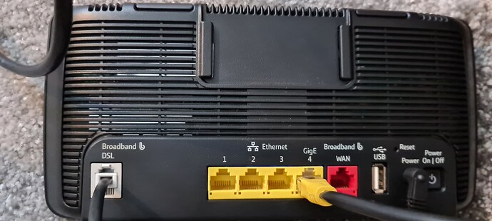

I hardwired the iMac to the BT Hub and installed the Roon Core. Four hours later, no dropouts or Reboots. Rock solid.
Four hours previously, the iMac was just Wi-fi connected and had four dropouts/Reboots within 90 minutes.
I will now reconnect the Nucleus to the Hub to see what happens.
I know this surely can’t have anything to do with it, but I connected the iMac to port 4 on the Hub. Previously, the connection was ports 1-3.
Port 4 on the Home Hub is the only Gigabit ethernet port - ports 1-3 are only 10/100 mbps…
Fingers crossed.
Would port 4 have a different outcome than ports 1-3?
The Nucleus has a gigabit ethernet port, but I would have thought it would be able to negotiate a stable/reliable connection to one of the 10/100 ports on your router, even though your recent iMac to port 4 test would suggest otherwise. Let’s hope this is the solution.
