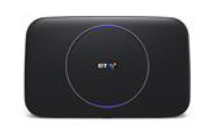

OK thanks, that’s clarified things. The only difference between your line and a “normal” line is yours is fed directly from the telephone exchange which suggests that you are quite close to the exchange as well.
Smart hub two has a circle on the front so easy to identify:-
As mentioned by Simon there is obviously an issue on either the Nucleus or Hub but it will most likely be easier to prove the hub, the factory reset is pretty easy to do and only should take around 10 minutes + any local settings time, if required you could try persuade your openreach contact to try a replacement hub!
