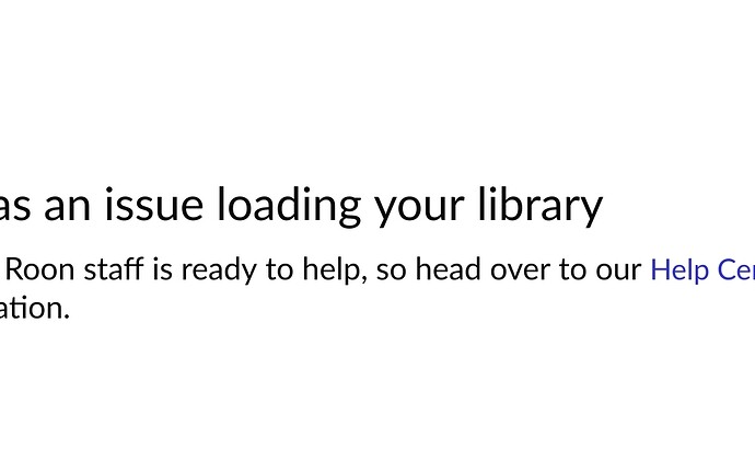

New Nucleus One, can connect, but goes into endless loading and database error
I've followed the Roon Troubleshooting, but to no avail : Troubleshooting - "There was an issue loading your database", endless loading at launch, or missing all audio devices."
I can’t connect to the Nucleus One based on it’s IP address I’m seeing in my router, it gives an unavailable error in the webbrowser.

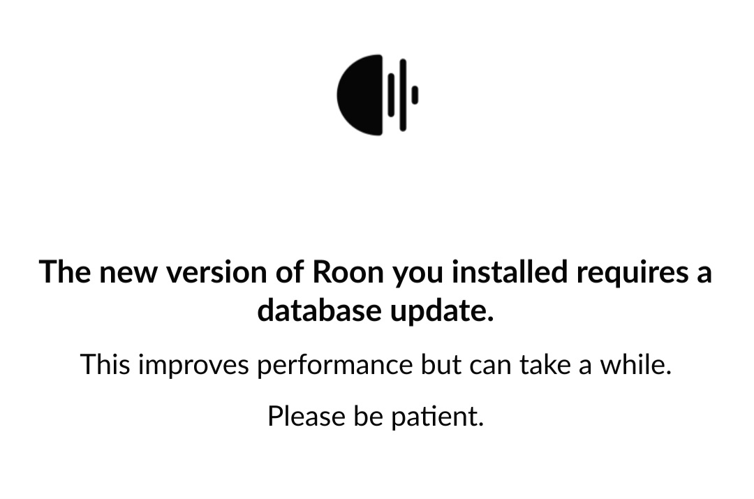

I restored the backup from my Roon Rock from a USB HDD. After this the database needed to be updated which would take a while? After this I got the message that I had to update my Roon version because it was outdated, and then things went wrong…

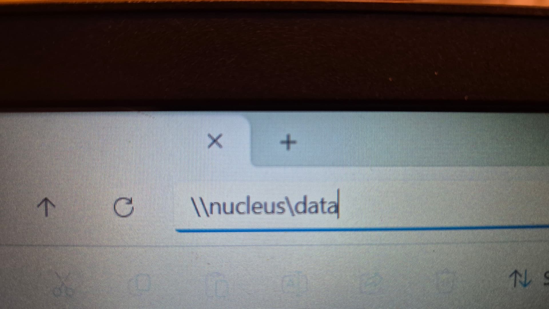

Hey @benjamin
This is what I see:
![20250213_185907|690x270]

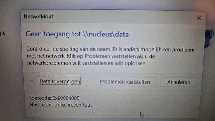

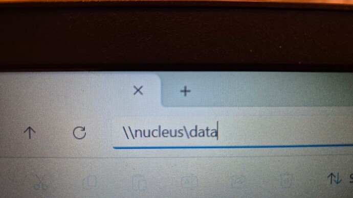

I can now go to this url and was able to stop Roon
But when navigating to \nucleus\data there is no reaction.
Thx

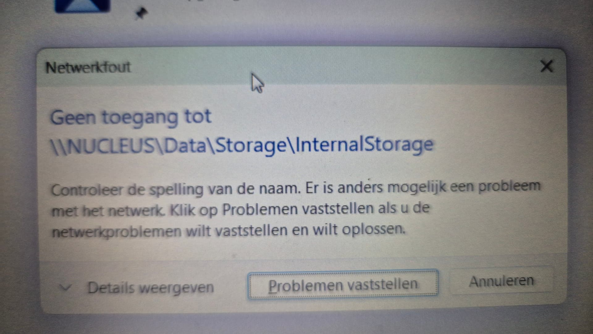

Hi @bernardb50,
Windows paths can be case sensitive try this path \\NUCLEUS\Data\Storage\InternalStorage
Sorry
There may be two issues at play here (and I suspect it is the first):
  1. Changes that Microsoft has made to security means that it is no longer possible to access Nucleus or ROCK folders. Then the Group Policy Editor of Windows can be used to work around this.
  2. Windows File Explorer has a habit of not finding non-Windows devices in your network until it’s told to do so. So typing \\nucleusone\ in the address field (note: NOT the Search field) of File Explorer will kick Windows into displaying it again. In this situation, mapping a Windows drive to a folder in the Nucleus will pin it permanently in File Explorer as a drive on your PC.
If you have issue 1, then this article explains how to gain access to the folders on your Nucleus+:
> TECHCOMMUNITY.MICROSOFT.COM
Accessing a third-party NAS with SMB in Windows 11 24H2 may fail | Microsoft…
Changes to SMB security in Windows 11 24H2 release preview may prevent access to third party NAS appliances or other devices.
You want to start at step 6…
\nucleusone\ does it!
Ah yes - I missed the fact that your Topic title refers to a Nucleus One , but you had been using nucleus in the address… Glad you got there in the end…

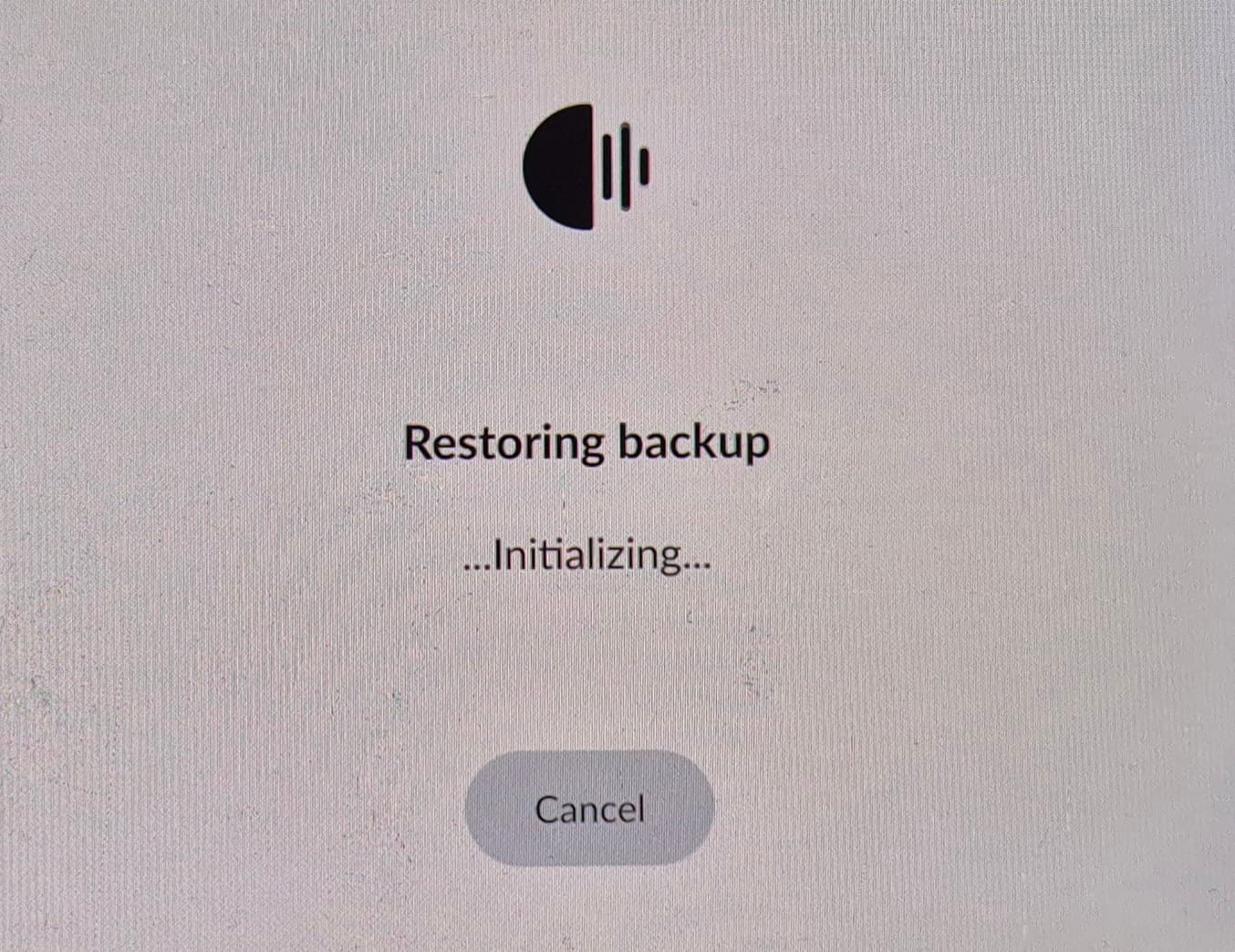

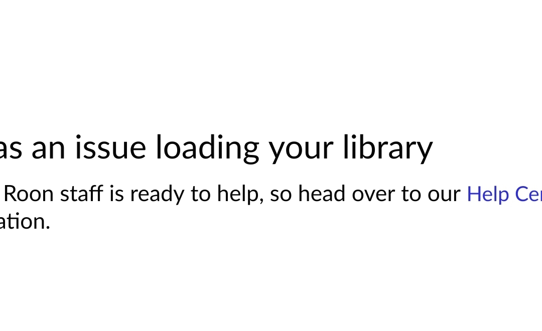

I restored backup anyway:
Phone
Tablet:
Back to start :man_police_officer:
Nucleus One up and running! Thank you team Roon! Have a great weekend :star_struck:
