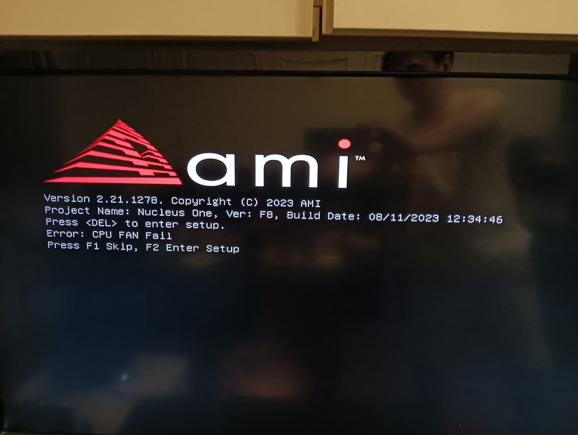

With that, can you next plug the Nucleus into a monitor via HDMI, while still connected directly to your router via ethernet, and share a screenshot of what you see?
This is the screenshot that connect to a monitor. What to do next?

@csk33kimo if you plug in a USB keyboard into the Nucleus and press ‘F1’ to skip, are you able to successfully connect to the Nucleus?
In the meantime, our development team is looking into things further. :+1:
Hi, @benjamin ,
Nucleus One can be connected to network and operated well first time after I pressed F1 at the above screenshot step.

Hi Csk33kimo,
Fellow user here. Messaging because I don’t want to add extra noise in your discussion with Support. Going into the BIOS and changing the wrong variable can cause additional issues and would suggest not changing anything unless advised by support.
Even so, there is nothing you can set in the BIOS, the message is clearly the CPU Fan has failed. You need to RMA the unit. The Nucleus One has a fan to control cooling, and running the unit without proper cooling can lead to further damage.

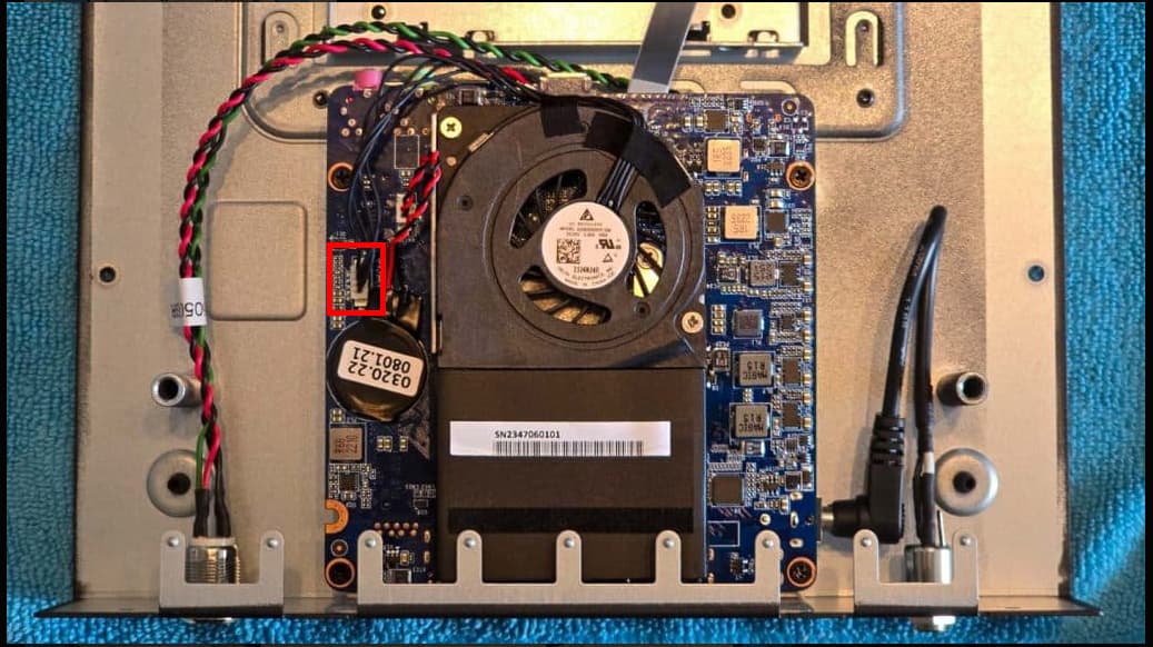

Hi @csk33kimo,
If you’d be comfortable trying this, could you please open up your Nucleus One, and review the CPU fan connection? Here’s a screenshot of what you’d be looking at, with a red box around the connection you’d be reviewing.
If you’re not comfortable performing this task, we can certainly get the unit sent back in.
Let me know your thoughts! :pray:

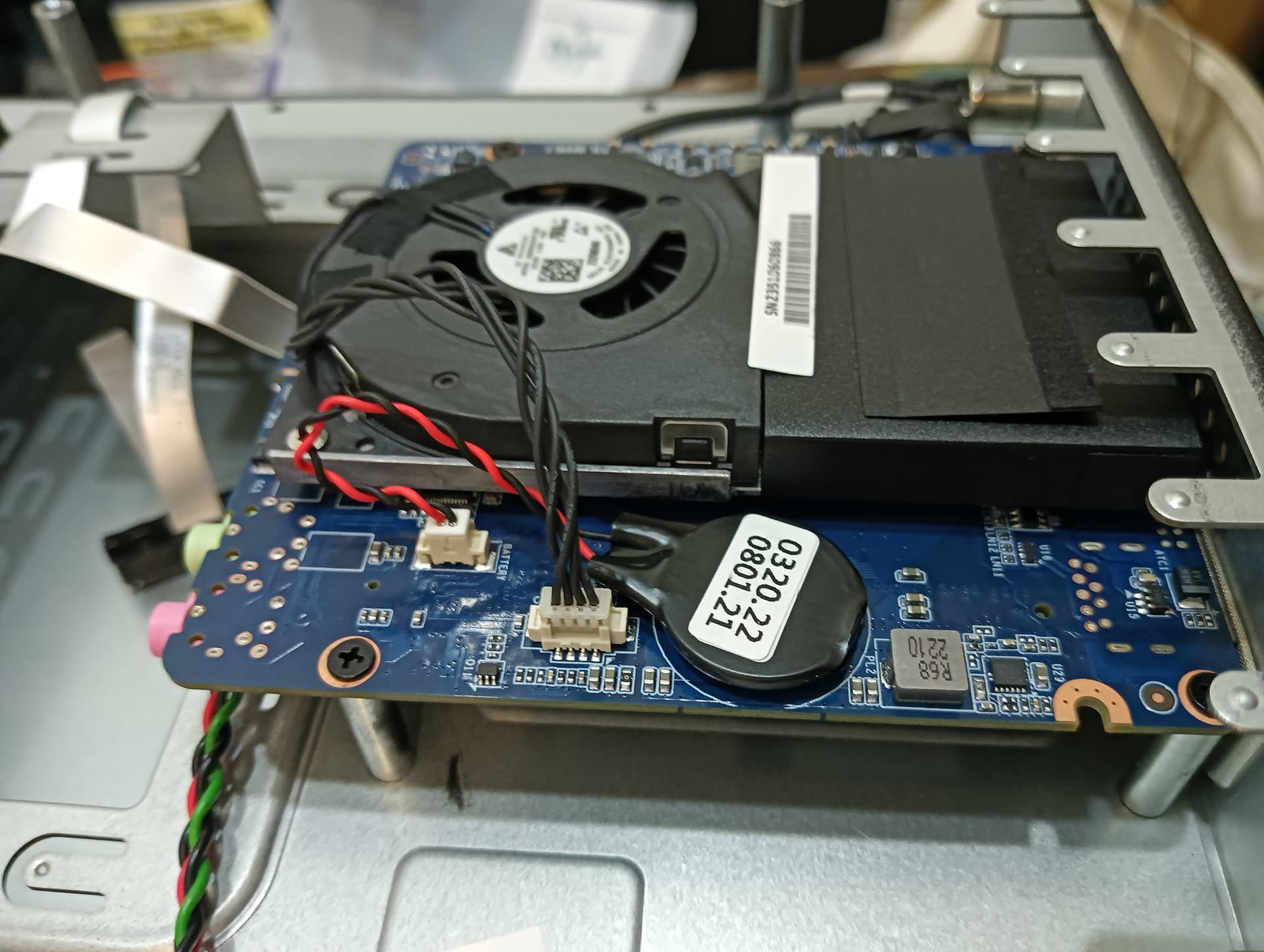

Thank you @benjamin for the tech support.
I am going to open the box an check the red box you just indicted.
Wait for my results… :smiling_face:
@benjamin
This is the picture after the opening of the box. What shoud I do in next step?
The connection here seems okay.

Hi @csk33kimo,
Thanks for sharing the screenshot! It does look like the connection is fine - can you safely unplug, and reset the cable in before closing the Nucleus back up?
Let me get back to you on this - I’ll check with the RMA team on what options we have.
Using your Nucleus without a fan is a dangerous thing to do, as the Nucleus has a thermal regulation setting that relies on the fan in case things get too hot. We don’t recommend using your Nucleus if the fan is not functioning properly.
