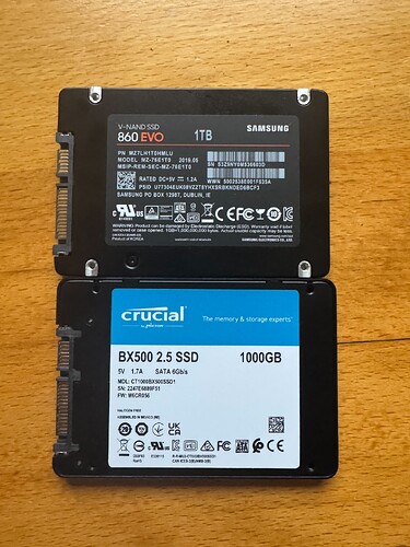

I have tried two SSDs:
Samsung 860 EVO
Crucial BX500
Both are 1TB, but neither is recognized.

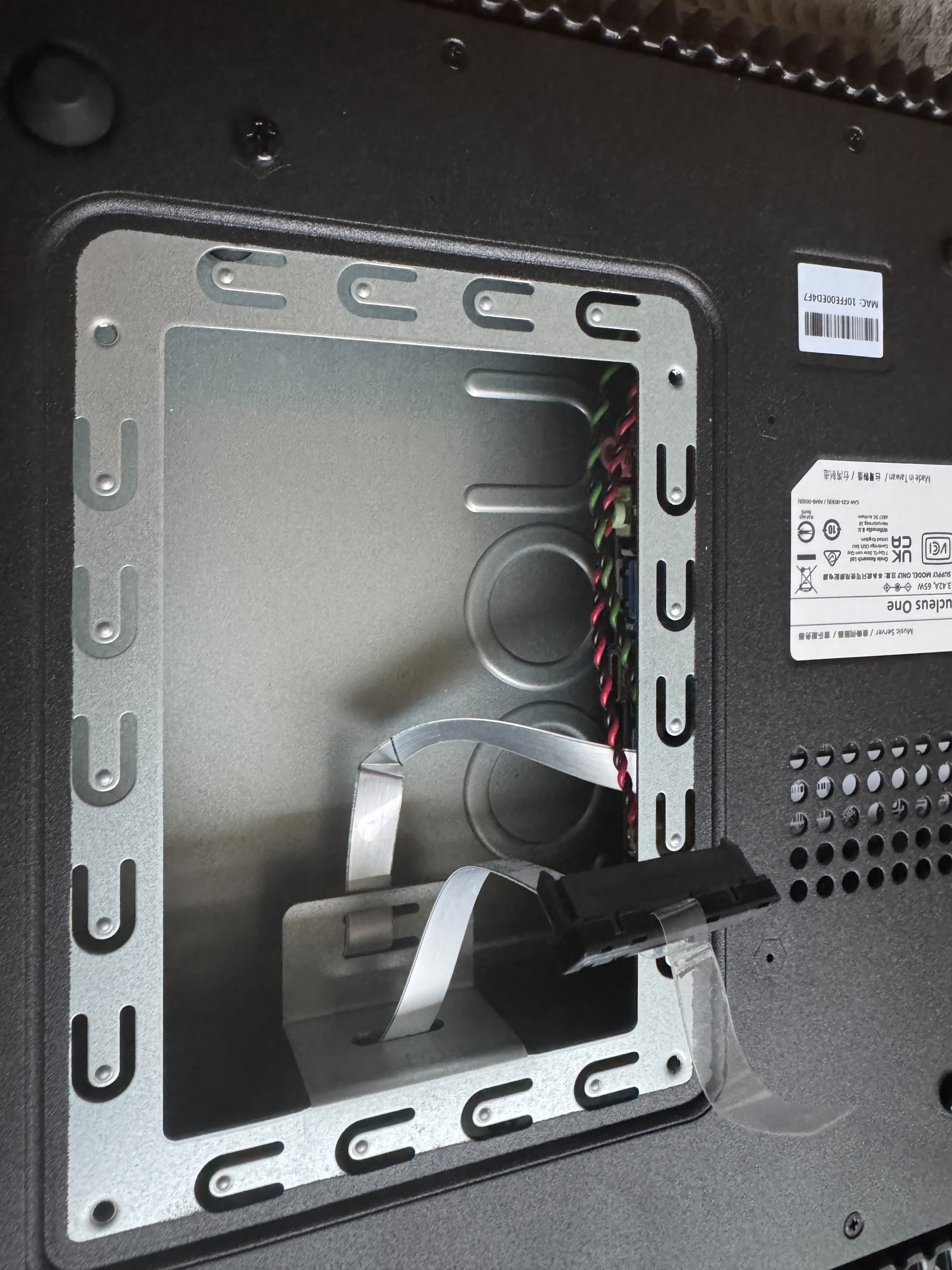

Since the Nucleus One runs without any issues apart from the problem with the internal hard drive, I assume that the connection cable was already defective before delivery. I need support to get a replacement cable. Similar cables are available on Amazon at a very low price.
If necessary, I would order a suitable one myself. However, since I don’t know the pin configuration, it’s not that simple. I would need this information from support.

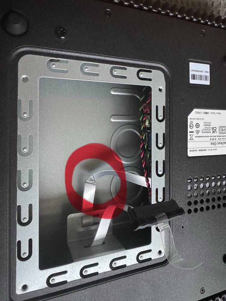

Hello, when I look at the picture, I can see some damage! Or is the picture deceptive?
Maybe damaged by the metal clamp!!
I believe that’s to be expected - it’s to turn the cable through 90° I think.
Look at the photos in the official help article - it’s the same there.
Notice also the instruction for requesting a replacement cable in the article:
Warning
If the SATA cable was damaged during installation, please note that this will not be covered under warranty . Replacement cables can be purchased if you choose to replace them yourself. Alternatively, we can open an RMA case to replace the cable for you.
For more information or to request a replacement, please submit a request using this online form.
Or simply rotate the SSD in the holder! Bottom to top!
