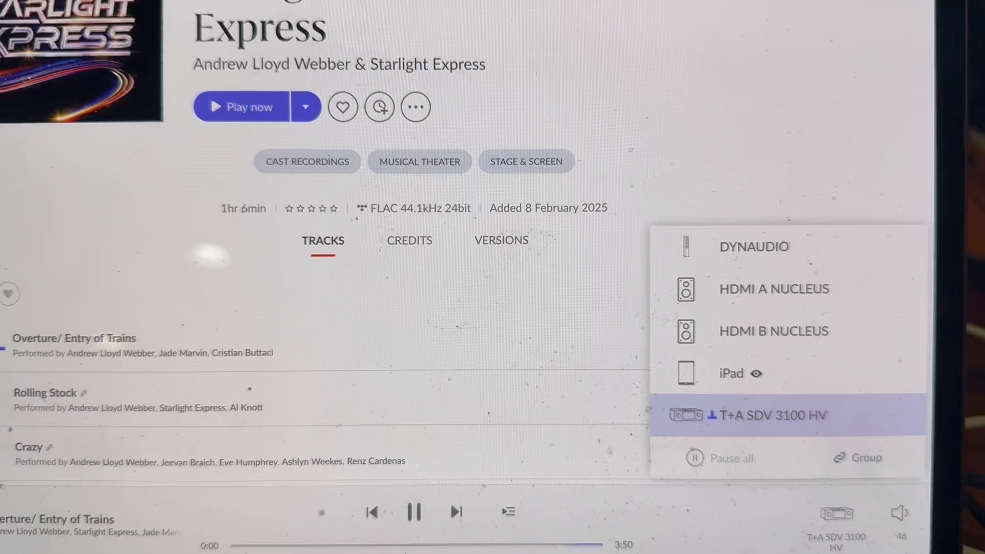

The Nucleus Titan powers on correctly. I have tested the ROON app on two different iPads and on my Mac Studio, and it works. However, when I select a song from Tidal, Qobuz, or from the Titan’s memory, it does not play. I have tried it with a T+A 3100 preamplifier and Dynaudio 50 speakers; the app appears as if it’s playing, but the song doesn’t even load for playback.

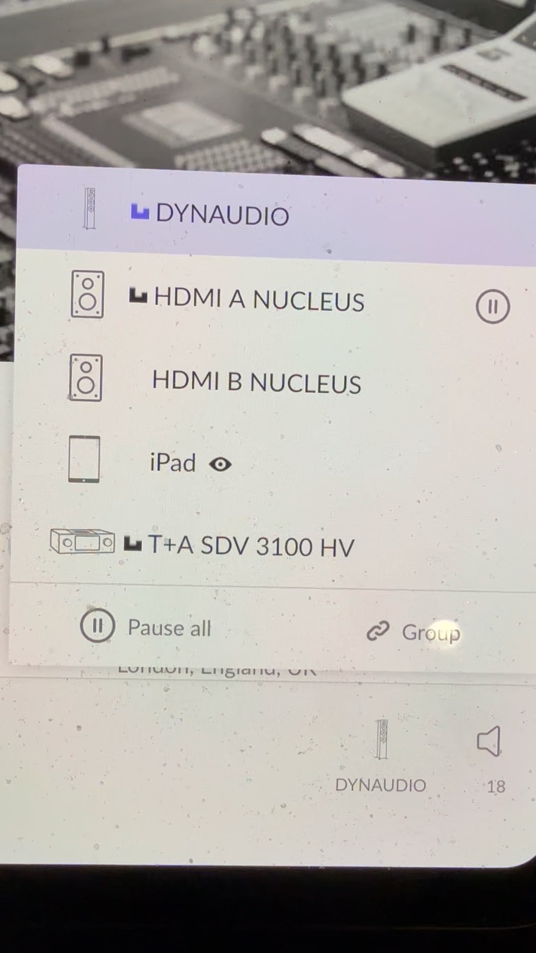

It went crazy—I have uploaded some videos of the app screen, and it looked like it was playing to HDMI A Nucleus, the T+A preamplifier, and the Dynaudio Focus 50
speakers simultaneousl.
However, there was no sound out of any.

Then, I selected a different album and tried to play it on the T+A SDV 3100—it didn’t work.
I sent you a series de of video and the final 2 video and picturein the previous upload link.

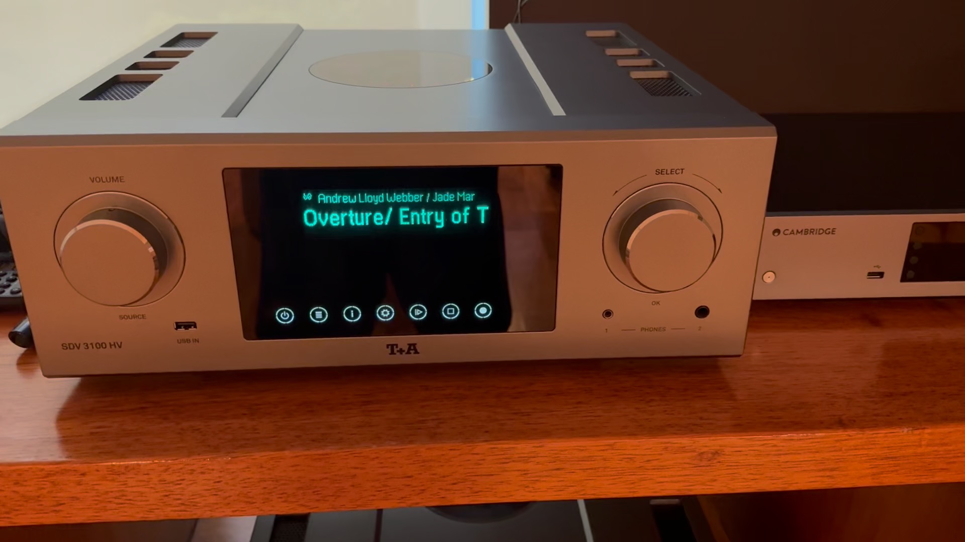

n the app, it appears as if it was playing in the app screen and in the T+A SDV 3100 panel screen,
but there is no sound.

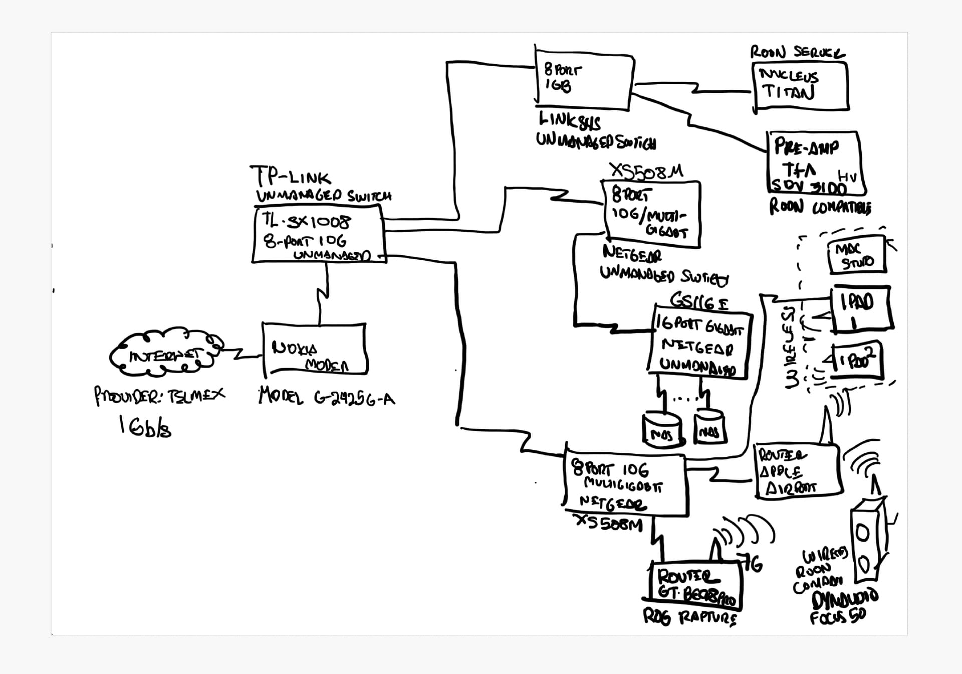

Attached you will find network diagram and Network topology
Home network Topology
Layer I. Modem from Internet Service Provider (Telmex)
Nokia. Model G-24256-A
Layer II. TP-Link Unmanaged Switch TL-SX1008 8 Port 10Gb
Branch 1.
Layer III.1 Linksys Unmanaged Switch SE-3008 8 Port 1Gb
Layer IV.1 Nucleus Titan Roon Server
Layer IV.2 T+A Preamplifier Roon Ready SDV 3100 HV
Branch 2
Layer III.2. Netgear Unmanaged Switch 10Gb/Multigigabit XS508M
Layer IV.1. Netgear Unmanaged Switch 16 Port 1Gb
Layer V. 2 6 Western Digital NAS
Branch 3
Layer III.3 Netgear Unmanaged Switch 8 Port 10 Gb
Layer IV.3. Asus ROG Router Wireless / Wired Router GT BE 98 Pro 7G
Layer IV.4. Apple Air Port Router Wirless / Wired 2.4GHz / 5GHz
Layer V.1. Dynaudio Focus 50 Wireless / Wired Speaker … Working as wireless
Layer V.2. A couple of Apple iPads Pro w/Roon App installed
Layer V.3. Apple Mac Studio Pro

Which router is serving the Nucleus Titan? Which router is serving the Dynaudio? The most expedient test is to connect these two devices via hardware to the same router - you can perform the same test with the T+A endpoint.
The most recent diagnostic logs show RAATServer announcements form the Mac received by the Nucleus at unusually frequent intervals. This is sometimes evidence of a multicast issue - if we can simplify the network chain and rebuild, we should be able to isolate the pathway between these components that aren’t handling Roon’s traffic as expected.

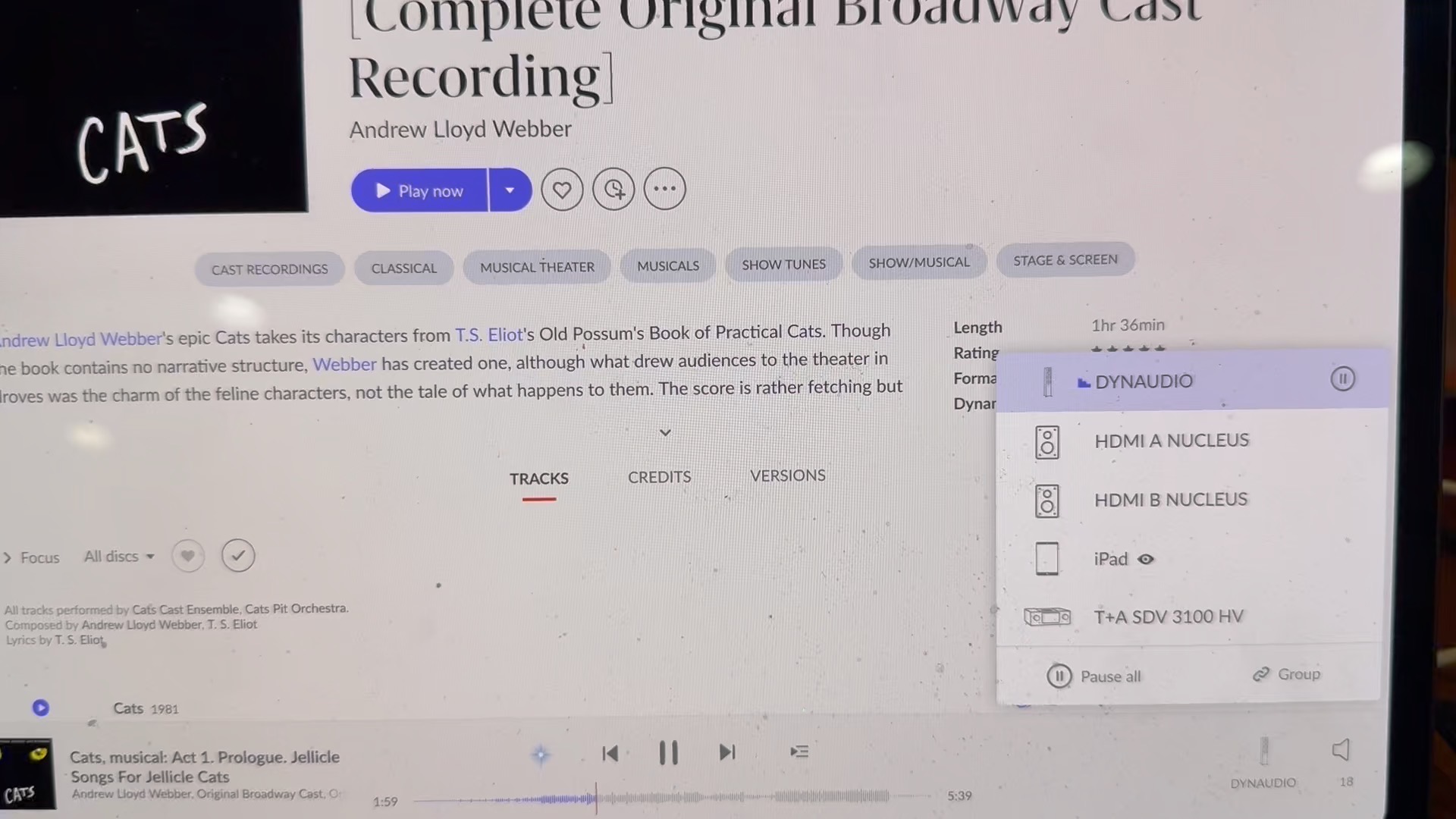

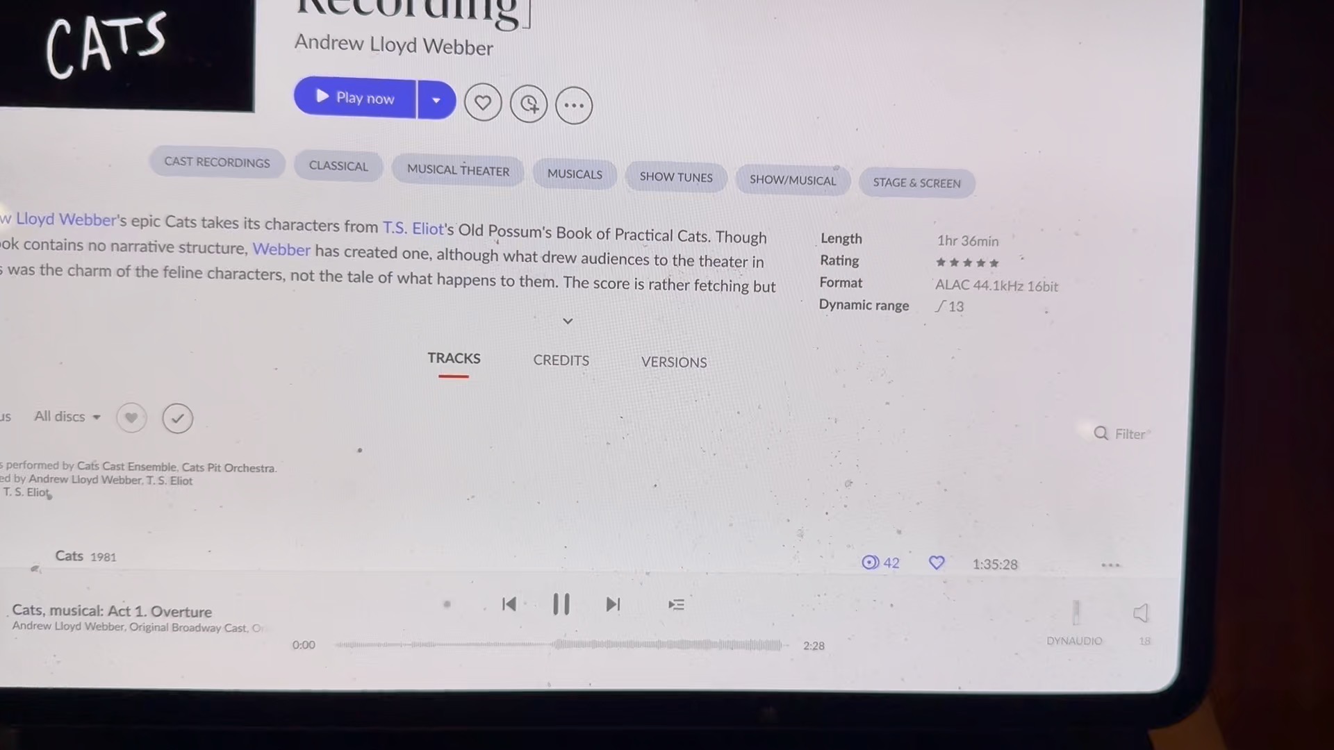

    a) I play some music from Cats. It worked fine.
    b) When I selected a new Albium, Starlight Express a clicking noise was heard in the speakers and it stopped working

I selected Dynaudio Focus 50
I selected Qobuz
I selected Dynaudio Focus 50 Speakers
It played well

I notice in the Apple Mc Studio App and It looked as if the SDV 3100 was playing
I checked the screen in the SDV 3100 screen and it appear as if it was playing
However It didn’t play anything

Now I am switching from Dynaudio Focus 50 speakers
Now I am playing both in Dynaudio Focus 50 speakers and T+A SDV 3100 HD preamplifier
Test 010
Now I switch song to Starlight Express and T+A SDV 3100 HD preamp again clicking noise was heard in the speakers and it stopped working.
In the App still appears as both Dynaudio Focus 50 and T+A pre and amp playing
No sound out at all.
