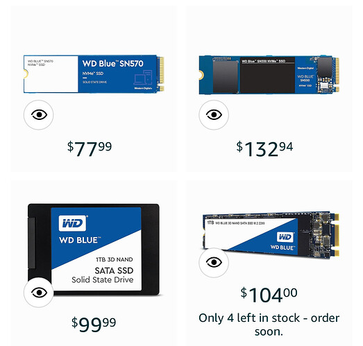

Thanks! Are they the stick size or the bigger ones?
The bigger ones, fit the $99.99 one in your pic for your local music files.
MikeB is correct. 2.5" SATA SSD is what you want. :+1:
