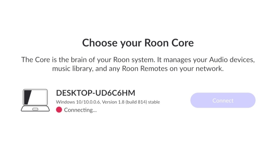

Hello!.phone and tablet do not connect to roon core on pc!
help please fix this problem

I just installed the program on my computer yesterday
everything works fine on pc
but the program does not run on android tablet and phone and did not start before

Thanks for the details, @aleksey_boguslavsky. First, on your Windows machine, can you try disabling any antivirus and firewall temporarily? Any change after doing so?
What kind of Android devices are you using? Can you also give us some details on your network setup?
Thank you! your advice helped
