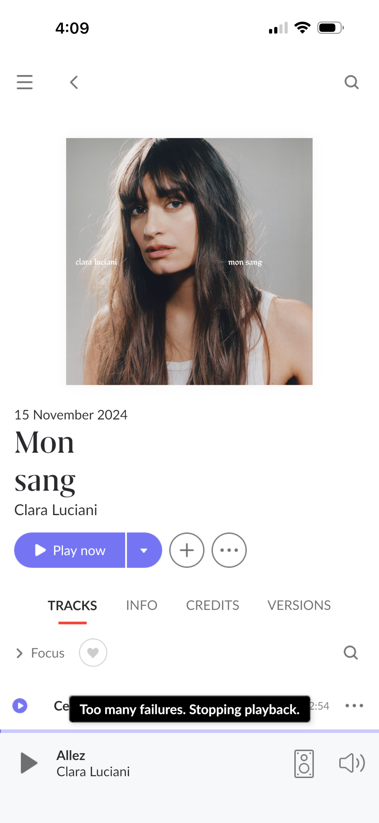

I am connected to the internet with ethernet, I have been using the Pink Faun server. After the last firmware upgrade, it stopped playing music even though I am connected to Roon as is the PF. It initiates as if it is going to play and after a few tries I get a too many failures error. I followed advice on the forum to shut every thing down and reconnect but that did not help.

I recommend working with Pink Faun guys to revert the ‘firmware’ update and/or let them know of the problem.

Roon doesn’t touch anything related to the hardware component of the Pink Faun, including the firmware! @Larry_Post is correct with their above comment, getting in touch with Pink Faun directly would be the best next step for you here. :+1:

A few next steps for you to try:
  1. log out of Qobuz in Roon, and re-login to resync your account.
  2. Reboot your router, and test out using different ethernet cables/ports
  3. Test out using a different output - can you stream Qobuz from the system output of your phone or computer?
  4. We have seen users have a better experience in the past if they change their Router’s DNS servers from the ISP provided ones to Cloudflare DNS, Quad9 or Google DNS. Can you please give this a try and let me know if it helps?
  5. Refresh your RAATServer database:
You can generate a new RAATServer instance on your device by following these instructions, but please be aware that this will reset your Roon Settings → Audio Tab to factory settings and I would advise making a backup of any custom DSP settings you have:
  • Create a Backup of your current Roon database
  • Exit out of Roon
  • Navigate to your Roon’s Database Location
