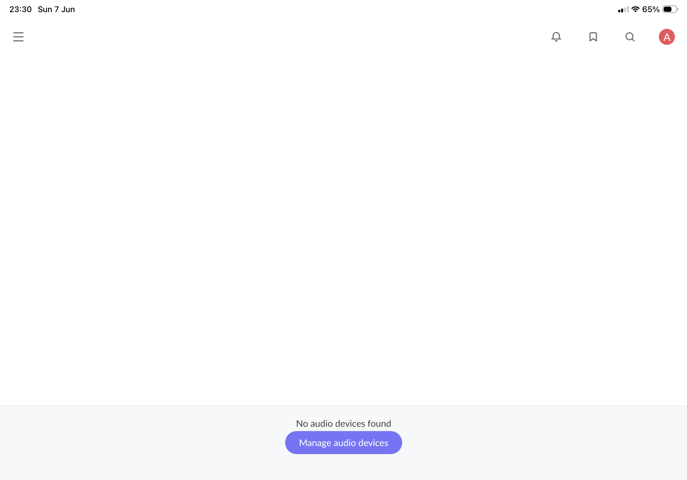

Playback and Interface Freezing with "No Audio Devices Found" Error (ref#8NX1XX)
· Playback stops slowly; the sound goes 'crackly'maybe pauses, continues then stops on. teh Roon Server followed several seconds later by teh Ropieee. The Roon Remote interface freezes then get message "No audio devices found". I have also seen screens that say there is nothing in my library and the there are no Live Radio stations. Eventually it all recovers and I can continue playing.
I have had issues with Live Radio dropping out for years now but this is different. It happens with Live Radio, streaming from Qobuz or from music stored in teh Roon Server.
Roon setup:
Roon Server version 2.67 (build 1661) running on an Intel NUC, this also has a Douk Audio USB to SPDiff interface supplying one sound system. Server has been up for 3 days, 14 hours, 18 minutes, 54 seconds during which time I have seen this problem many times.
Ropieee version 2.60 (build 1501) running on a Raspberry Pi Raspberry Pi 4 Model B Rev 1.2 2Gb RAM with a Douk Audio USB to SPDiff interface supplying another sound system
Roon Remote version 2.67 (build 1661) running on macOS Tahoe 26.51 on a Mac Studio M1
I have zipped the Roon Server log files and can upload if needed
· Router is a BT Home Hub 2 supplying Gigabit ethernet, a Netgear 32 way switch, a 4 way hub. Entire system is hardwired with CAT5e cable

I have just checked the router’s DHCP lease time. It is set to 1 day 0 hours.
I have also fixed the IP addresses for the Roon Server and the Kitchen RoPieee at 192.168.1.98 and 253 respectively.
Lets see what happens now :face_with_monocle:
I am just checking with the router what it thinks the Lease Time Left is for the Roon devices.
At 01:04:29 local time, the Roon Server has 00:17:24:50 and the Kitchen Ropieee has 00;20:32:21 left.
That doesn’t look consistent with the 12 hour theory for 2 reasons; Both devices have more than 12 hours left, the expiry times do not line up with the 05:27 / 17:27 times.
Stopped again. According to the Roon Server log file, it went wrong about here:
07/01 17:27:27 [Local 07/01 18:27:27] Trace: [raat_ll/client] [HIFI DSD] OnDisconnected: BeginRead ead count is 0
07/01 17:27:27 [Local 07/01 18:27:27] Warn: [raat/tcpaudiosource] send failed: Broken pipe
07/01 17:27:27 [Local 07/01 18:27:27] Warn: [raat/tcpaudiosource] disconnecting + retrying
07/01 17:27:27 [Local 07/01 18:27:27] Debug: [raat/tcpaudiosource] disconnecting
07/01 17:27:27 [Local 07/01 18:27:27] Debug: [raat/tcpaudiosource] connecting to 192.168.1.253:40773
07/01 17:27:27 [Local 07/01 18:27:27] Error: [raat/tcpaudiosource] connect failed: Connection refused
And then it fails to reconnect.
Kitchen RoPieee stopped again this afternoon.
07/05 14:56:48 [Local 07/05 15:56:48] Trace: [HIFI DSD] [raatclient] SENT [14]{“request”:“end_stream”}
Seems that both Douk USB to S/PDIF converters are having problems
