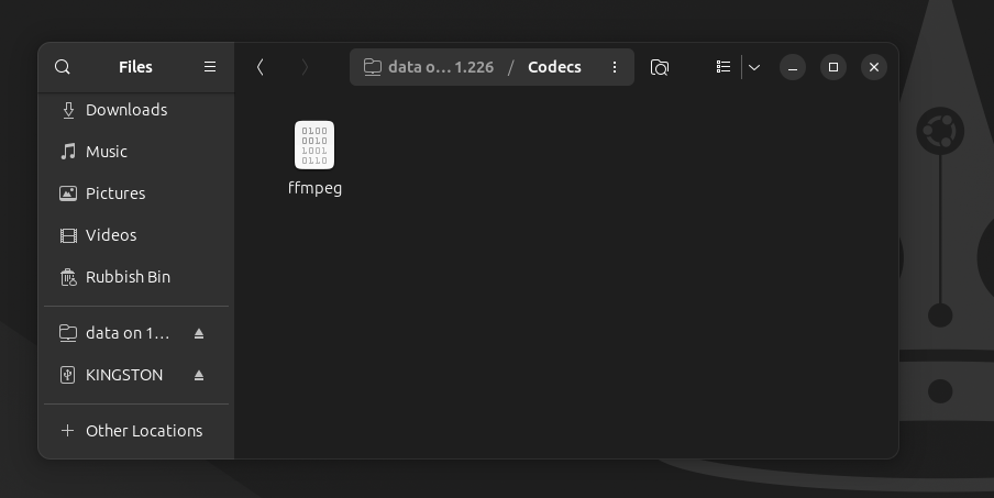

Yep, only one server. Here’s a screenshot of my codec folder (if this is what you mean).
A detail view grafik would show more (details). Sometimes the file size is “fishy”. So there is not much to go on from that screenshot, this could be 0 bite file with the right name just created with touch. The name is as expected though.
PS: You might also post the link to the codec archive you downloaded, sometimes people download an archive for the wrong architecture.
