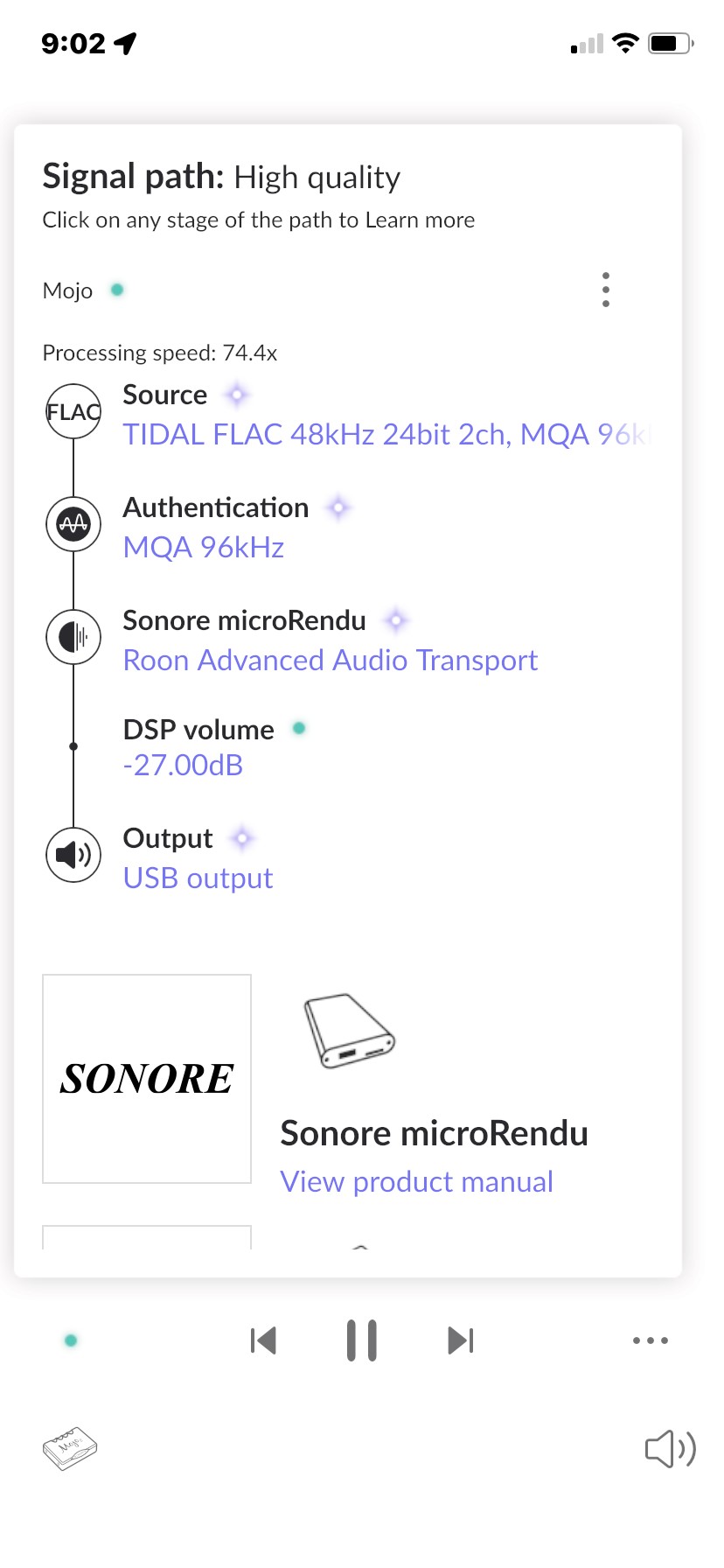

I attach screen shots of Roon set up including a DAC diagnosis.
The MQA decoder in Roon is not turned on as your Mojo is not an MQA compatible DAC so you get the delivery sample rate of 48k. This is a change Roon made to its default stance for MQA in the last but one update. So Looking at your signal path it’s sending undecoded MQA without Roons core decoding. Turn the core decoder on and set MQA capabilities to none as your DAC doesn’t support it. That said it should be 48k not 44.1 If that’s the source. You are a subscriber to Tidal Hifi Plus? If it’s 44.1 then something after Roon in the rendu is making it 44.1 but in your screen grabs it’s showing 48 for the ALSA output of the Rendu, not sure where your getting 44.1 from

From the signal path you posted the file being played is a 48k MQA file. Without Roons MQA decoder on that is passing through at 48k which is correct. It’s expecting the DAC to decode and Render it higher. Your DAC can’t it’s not MQA capable. Turn on MQA decoding in Roon it will spit it out at 96/24.
What makes no sense is you claim it’s coming out 44.1 where Roon does not show this. Therefore it must be after Roon somewhere that’s converting to 44.1 or you not reading the mojo correctly.

Now you have turned on the decoder can you repost a signal path playing an MQA file.
Here they are. Same readings as last time and still showing 44.1KHz on MoJo 1 when previously with same system it showed a 96 sample rate.
Your Roon core MQA decoder is not on. It should look like this. Also, turn off DSP volume in Mojo setup. It has on-board volume control buttons.
