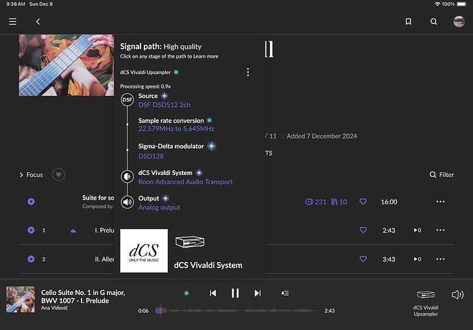

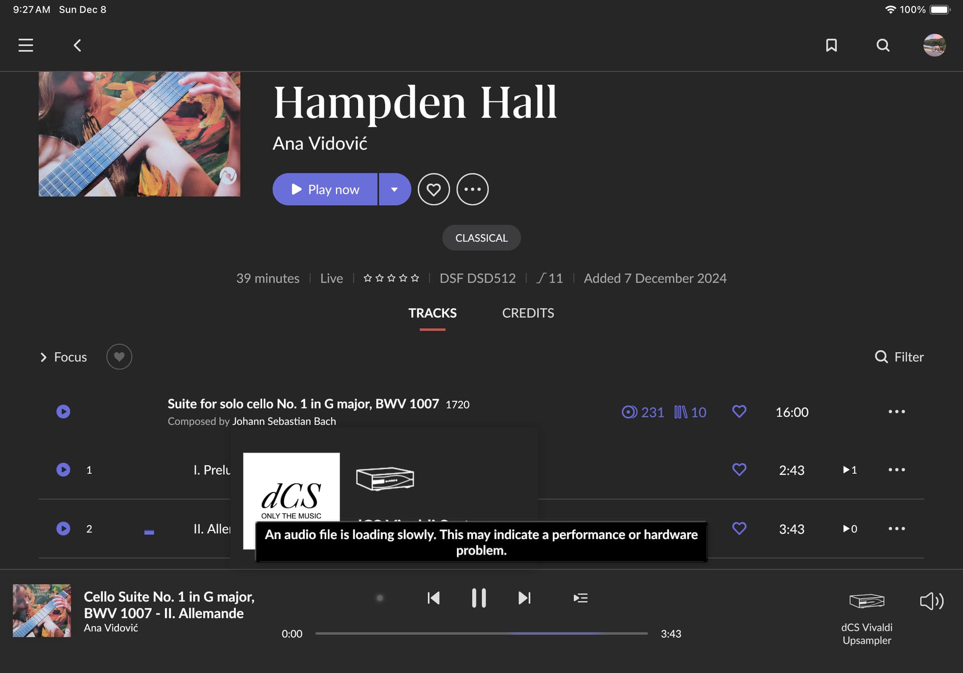

The first screenshot shows the signal path while it is playing seemingly find during the initial 10 seconds or so; and the second one after it stops in silence.
Ok, that processing speed 0.9 is most likely what is causing the issue.
With that much load on the processor for the conversion it does not leave much for the other roon requirements.

Interestingly, the Roon message points to the file I/O as the problem, not the processing power. I guess the processing power could still be the limiting factor, especially given the “0.9x” status. Not sure what “0.9x” processing actually indicates, in terms of threads / cores / CPU …
