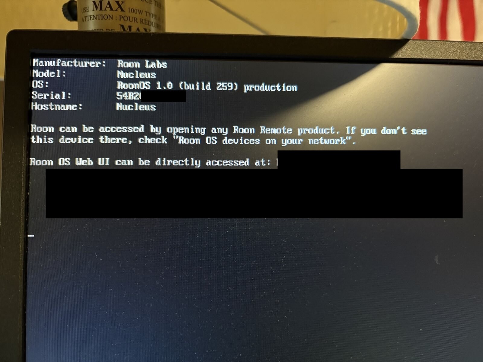

I followed the troubleshooting on this post from 2023. Green light and white light shine when I hit the power button (see photo below), and I get the message in the attached image on my computer monitor connected via HDMI. The Nucleus also shows up on my network.
Does this mean all is well save for a fried power button light? Is there an easy fix for this?
Those boot messages appear normal to me. Can you access the Web UI?
If the remote can connect to the Nucleus and you can play music then it could be the power light is burned out.
Thanks for the info, Mike, on the boot messages. Things appear to be functioning correctly.

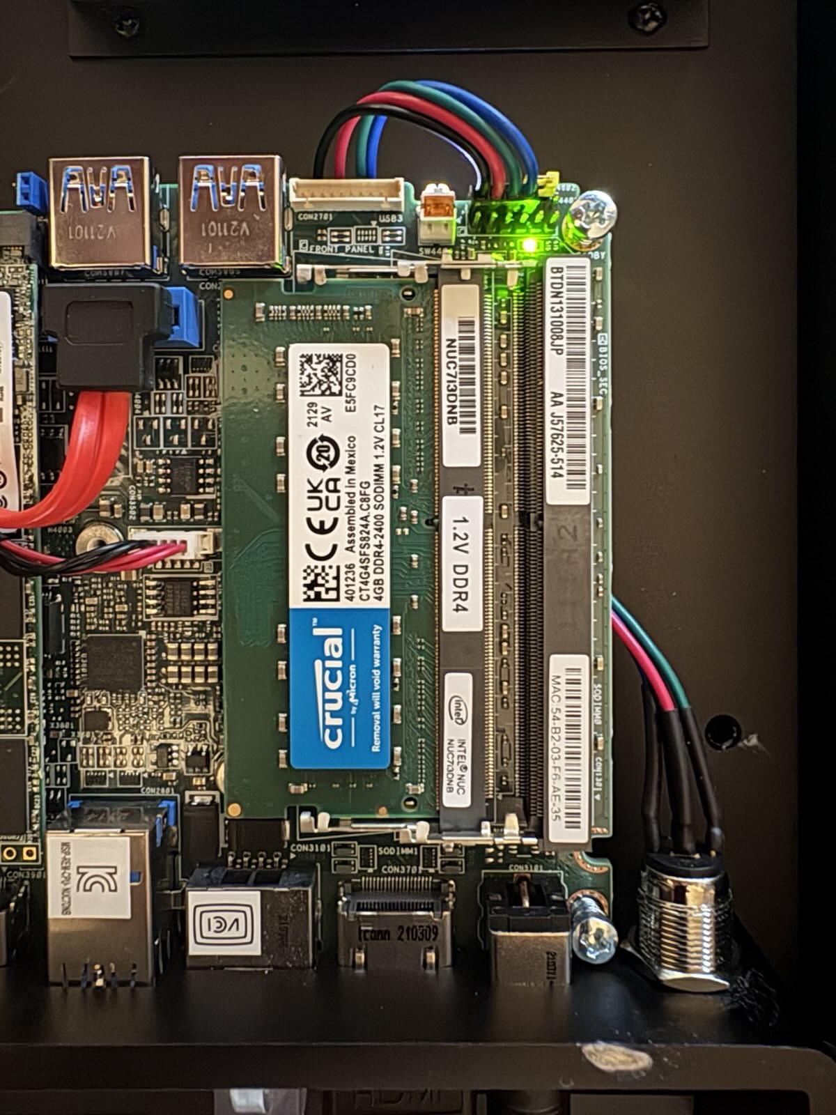

What is interesting is that I could not get the Nucleus to power on – no message via HDMI on the monitor and not showing on the network – until I took the bottom off the Nucleus. I realize now I should have mentioned this in my original posting – it might be the key twist.
I want to be sure nothing else is wrong so that it dies sometime after I put the bottom back on.

Did you disconnect the Nucleus from power when you removed the bottom plate? Cycling the power could explain why it started up after this.

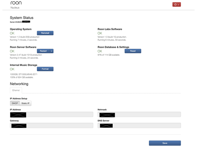

Thank you for your patience. Diagnostic logging indicates that the Nucleus can power on, but is encountering generic errors attempting to access upstream servers and other Roon devices on the network. That’s good news, in that there’s not a BIOS-level failure recorded by the unit. However, it might point to problems with the Nucleus network interface or the underlying network. The unit hasn’t pinged our servers in two days, however, and is currently running the previous (not the current) Roon build available.
Please share a screenshot of the RoonOS web admin page for this unit, along with a basic overview of the network topology involved with its internet connection (does it use the same router as your other Roon devices, etc.).

Thank you @daniel . Your instructions allowed me to gather the data @connor requested ten days ago.
First, the screenshot requested. I can DM you a version without the blackout data.
Second, the configuration: The Nucleus is connected to my wifi router via ethernet cable. The Mac running Roon is also connected to the same wifi router via ethernet cable. I sometimes use a iPhone and a laptop with Roon to control things, both tied to the wifi network offered by the same wifi router.
While I had the Nucleus set as my Roon Server, I ran an update of the operating system on it and I got a message that had been successful.
I also pulled the logs again. If you would like this set, send me the upload link again.
The only issue I can discern is the light on the power button. I am assuming this is a rare issue.
