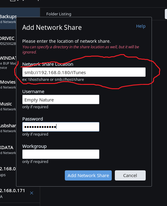

First, it was suggested by Mr. Fishgutz that I use another computer and attempt to share files between them. Great suggestion. I have a a second Mac, an iMac, and I went through the steps to share files between the Mac Mini and the iMac. I inputed the same information that I inputed into the Roon: smb path, user name and password; and viola, I was able to share files between the two computers. You interpret that as you wish. As far as following the procedures outlined in your manual and having the correct set up in the Mini to do that; Yes, I have done that. I have checked it three times. The fact that I can share files between the two computers implies that the set-up is correct. Correct me if I am wrong.
I am attaching a screen shot from the Mini. I do not have one from the iPod as I am locked out of Roon Controller that is on it…again!
What you see from the screenshot is the address I have entered in the Roon and what I entered in the iMac (The file sharing that worked).
I noted Mr. Gillespie’s suggestion. It is worth a try. If, and when, I can access the Roon software again I will give it a try.
Hi @Herbert_Summers,
Can you share a screenshot of the Share Options menu too, as mentioned above? image
The page you requested is attached. As I mentioned in a previous e-mail, sharing seems to be working with my other Mac.

Hi Herbert,
In your Sharing screenshot, it appears you haven’t selected (clicked the box) the user name you’re using in Roon. Maybe click both Herb and Herbert and then try again.
Cheers, Greg
In addition to the great suggestions above from Slim and Greg, can you confirm whether or not your password for the share has any special characters? If so, can you change it so that the password is strictly alpha-numeric and let us know if that helps?
