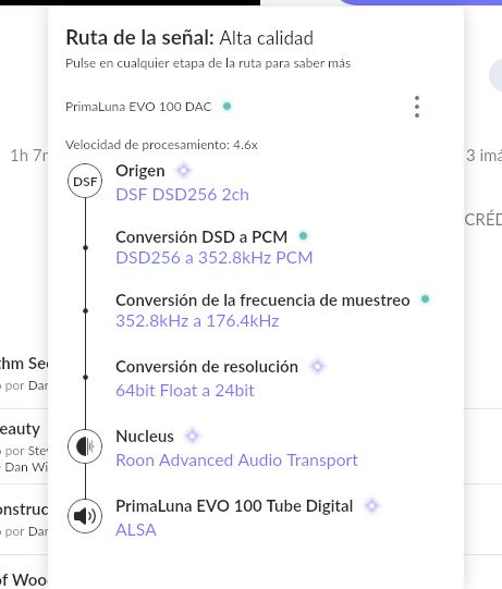

But unfortunately, after the last update, when I playback DSD256 Roon, converts it to PCM176,4. This is very disappointing for me, because I really like de DSD sound much more than PCM.

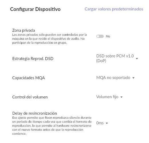

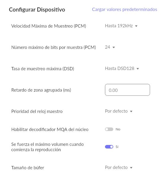

I send you the path of a DSD256 reproduction, and the image of the DAC configuration in Roon. With this configuration the system works properly for a year.

(Your signal path makes a kind of sense as DSD128 via DoP requires a 352.8kHz PCM package and your DAC is limited to 192kHz PCM - I’m puzzled as to how a DAC limited to 192 PCM can manage DSD128 via DoP but I’m by no means an expert.)

I just tried to use DSP to convert DSD 256 to DSD 128 but the result did no was as I expected. Roon first converts DSD256 in to PCM, and then convert to DSD128. I want to avoid the PCM conversion.
It seems like in one on the latest Roon updates, the down sampling in DSD has changed form a down sampling of frequency to a conversion to PCM. I suppose there is a mistake.

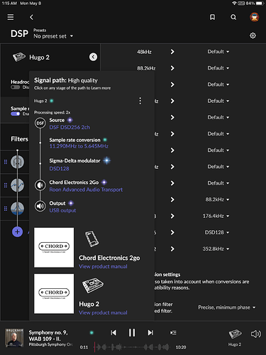

Enable “Native DSD Processing” in DSP engine, while keeping output as DoP.
In case your processing speed drops below 1.3, do not enable it.

I can convert DSD256 to 128 without seeing PCM conversion.
Thanks all.
The problem is solved. The problem was in the configuration of DSP engine.
