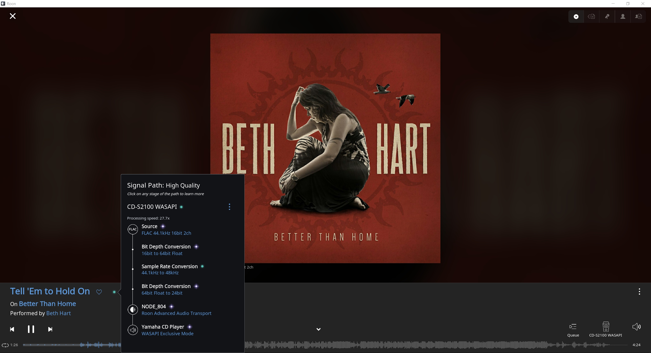

  1. Using WASAPI (Music Files stored on my NAS)
  • Every file is converted to 48Khz. See pictures …
