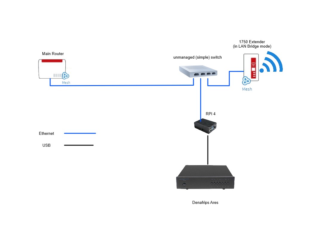

I don’t know whether it would be possible to alter the configuration in your case, but what I would do would be to put the 1750 into LAN Bridge mode, with a wired ethernet connection back to your (Fritz?) router, and introduce a simple switch alongside the 1750 to be able to connect both the 1750 and the RPi endpoint via ethernet. That way you will improve both the Wi-Fi performance of the 1750 (because it is in LAN Bridge mode), and the endpoint (because it is now wired).
So, the only thing I have to do is buy an ethernet switch and connect via ethernet the RPi 4 and the 1750 Fritz Extender to the switch?
Well, that, and to make sure that the 1750 is put into LAN Bridge mode… You should end up with something like this…

Ok RPi 4 to the switch and switch to extender but I can’t connect the switch directly via ethernet to the main router because it’s in another room. Is it the same?
Well, that’s why I asked you if it was possible to change the configuration to have a wired connection between the switch and the router - that is necessary to be able to put the Extender into LAN Bridge mode.
Without that wired connection, you’re still relying on a WiFi connection with your Core, and that’s almost certainly why you can’t play HiRes Qobuz files…
