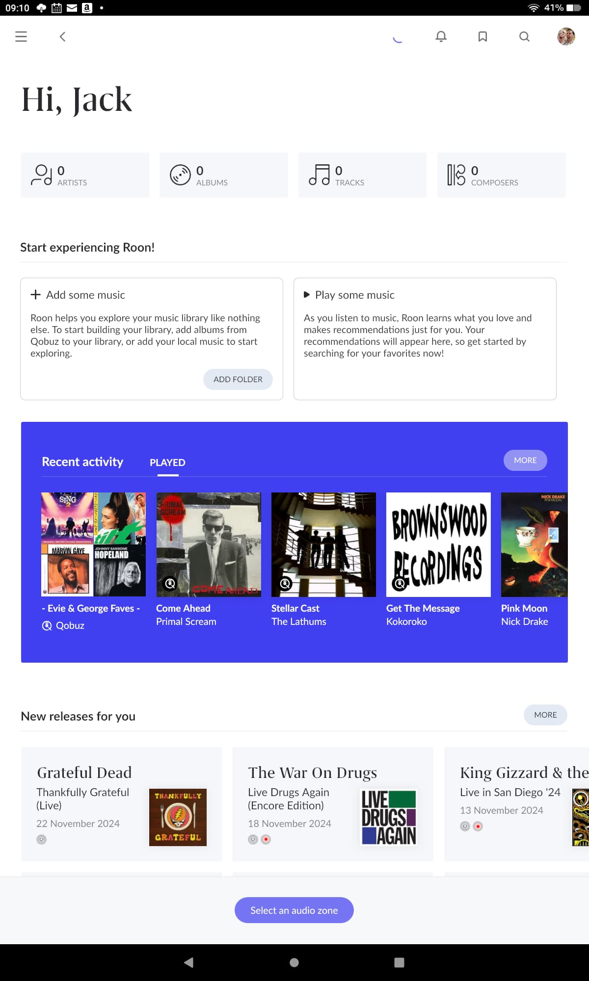

My new roon server on Mac mini M4 has deleted its library after a successful restore from a ROCK backup.
After more than 24 hours uptime I disabled the local storage locations, which seemed necessary to prevent the server from trying to synchronise Local files that were inaccessible. Soon after this, I noticed that Roon appeared to be gradually deleting my entire Qobuz library Album by Album, until it reached zero artists, zero albums, and presented as a fresh empty library.
I will be happy to provide screenshots and logs so that you can diagnose the cause.

Here are some grabs:

I am seeing some very strange behaviour again now, after 5th time lucky with restoring from my latest backup of former ROCK server. I’m watching on Roon Remote and it looks like this:
  • Albums count static at 5712
  • ‘Adding music to library’ process is running, now counting upwards from approx 50k tracks / 16k Identified… watched thru to 67k tracks / 25k identified.
  • Artists count started around 3100, but seems to be ‘arguing with itself’ and counting upwards and downwards… currently standing at 3021
  • Albums count is still static at 5712
Checking Storage in settings, it is evident that my local libraries are not accessible- and so I deduce that this is Roon debating its library with Qobuz.
I have not disabled the Folder paths under Storage-
this seemed to match ‘last known good’ before the issue occurred last time.
Will see in the morning, and try to remap the Storage folders if the counts are what I’d expect from Qobuz only.
