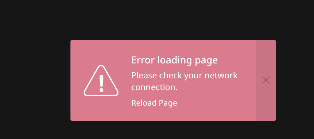

Since yesterday I have had issues connecting to Qobuz through Roon - most of the time it will not load at all and I get an error message.
I have no trouble connecting to Qobuz through the Qobuz app or using my Lumin streamer.
I tried to reboot the NUC (Roon Core) and I got an error message indicating that the device did not reboot successfully so I manually shut it down and then unplugged it. The error for rebooting still existed so I reinstalled the Roon operating system and still cannot connect to Qobuz or reboot the Rock through the web browser.
Operating system is Version 1.0 (build 227) stable and Server software is Version 1.7 (build 710) stable.
I am also getting an error with regards to metadata, see attached screenshot.

I have just powered it off again for 30 seconds but no change, still cannot access Qobuz - it starts to load the main Qobuz page and then an error message appears.
Just to clarify, I have no issues playing local files on the USB drive that is connected to the NUC and I can use Qobuz through their native desktop app and on my Lumin streamer.
One other thing I wanted to add - I also added Tidal to Roon and it will not work either.
I also tried Live Radio and it would not stream.

I tried once again to reboot the ROCK using the web dashboard and it failed, see photo…

On your screenshot here:
I noticed that your DNS server is a very atypical one. Have you made any changes to the DNS on your router recently? Can you please try to use Cloudflare DNS, Quad9 or Google DNS?
