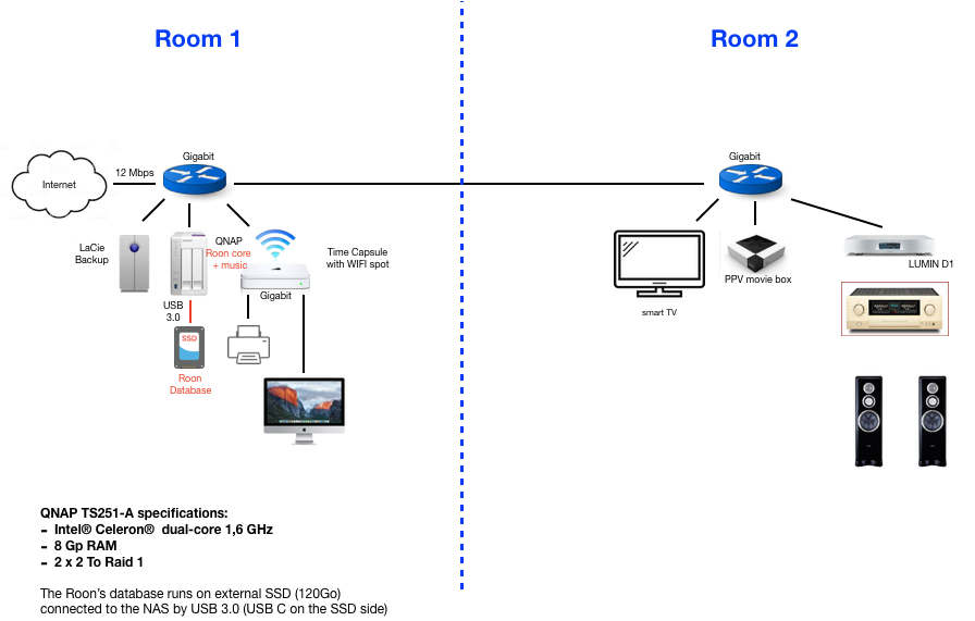

Here is the diagram of my home network. I moved Core on IMac and I still have some cuts while listening from Qobuz in 192Khz 24bit. Now I’ll try to move Roon server on my MacBook Pro to see if it changes anything, it is the most powerful Mac that I have.
I’m not sure if I understood your last question. To listen Qobuz directly I do not go through my Mac. The signal goes directly from the internet box to Lumin via two routers. See the shema. Note that I use this same network for movie streaming in 4k definition and I have no problems.

What are the two routers shown here? 12mbps is a bit on the slower end, especially if there is a lot of network usage here.
Ideally, we want to try to limit network usage as much as possible here and see how things work in a simplified setup. Here’s what I’d like to suggest:
If possible, connect the Mac to the primary router directly via Ethernet. Then go to Settings > Audio in Roon and choose System Output as your Zone. Play to System Output in Roon and let us know if this exhibits the same issue.

Now, 12Mbps is the real internet bandwidth measured with fast.com and not the network debit which is an ethernet gigabit. Knowing that 96kHz 24bit file needs about 3Mbps, my internet debit shuld be enough, is in’t it ? Regarding my network I only turn on LaCie when I need to make backup. It is currently off. Likewise fo TV and movie box. Obviously I don’t watch TV when I listen music. Honestly I don’t think the network is saturated.
